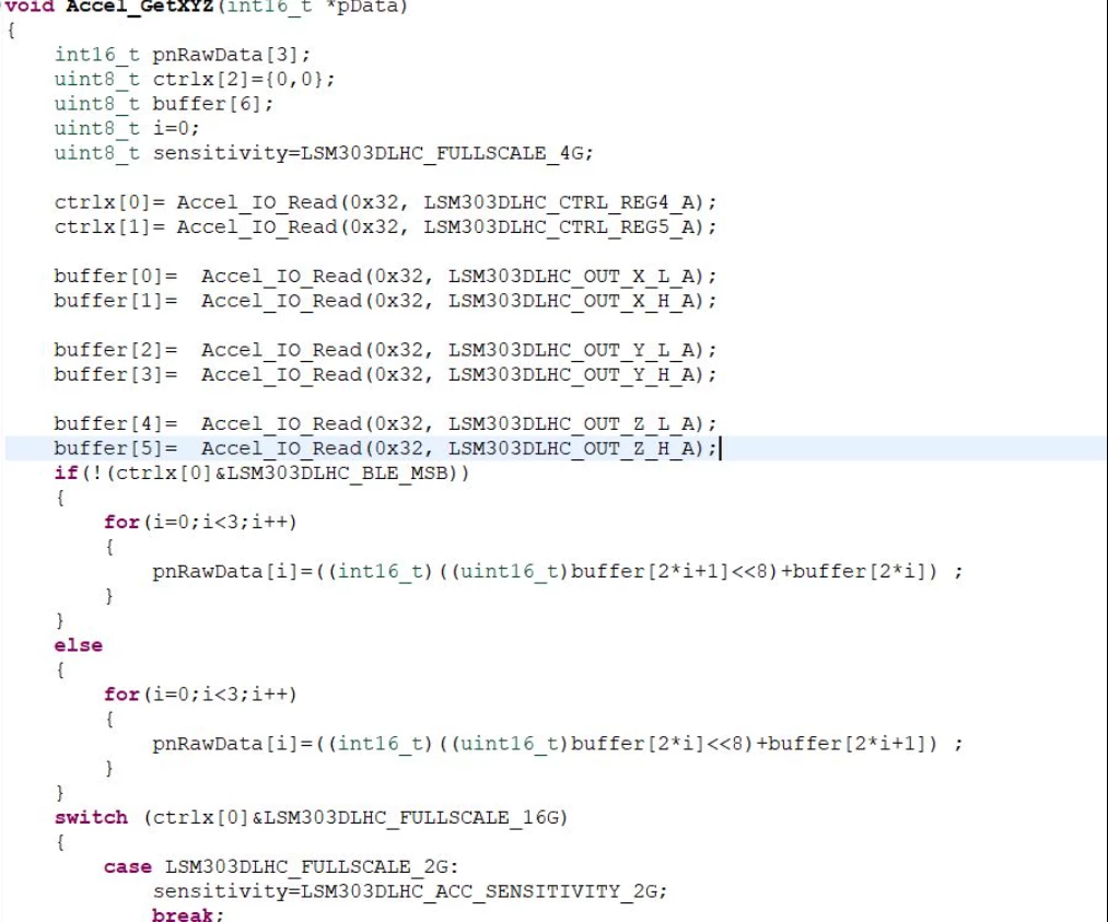

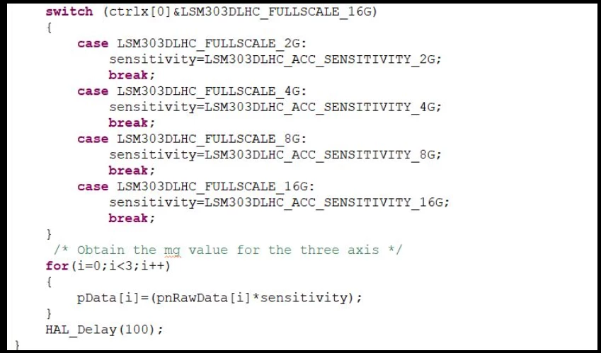

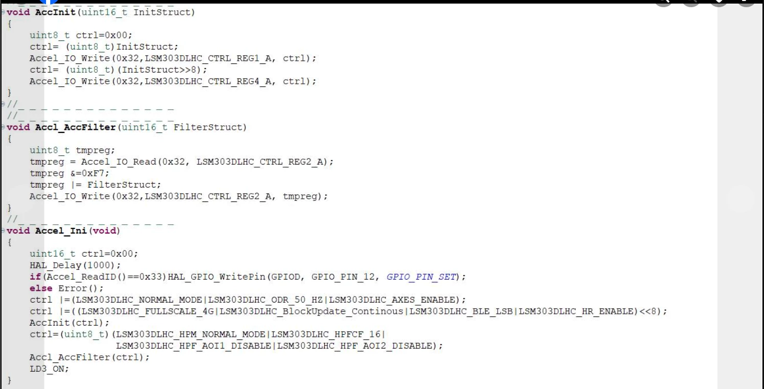

Hi everybody
I am testing the LSM303DLHC sensor on the STM32f411 Discovery kit. The values ​​of the three axes x,y,z are 600, 4800, 15040 respectively. The values ​​of the three axes x,y,z change when I move the board.
I don't know if the result is right or wrong. If wrong, how to correct it?
Thanks
