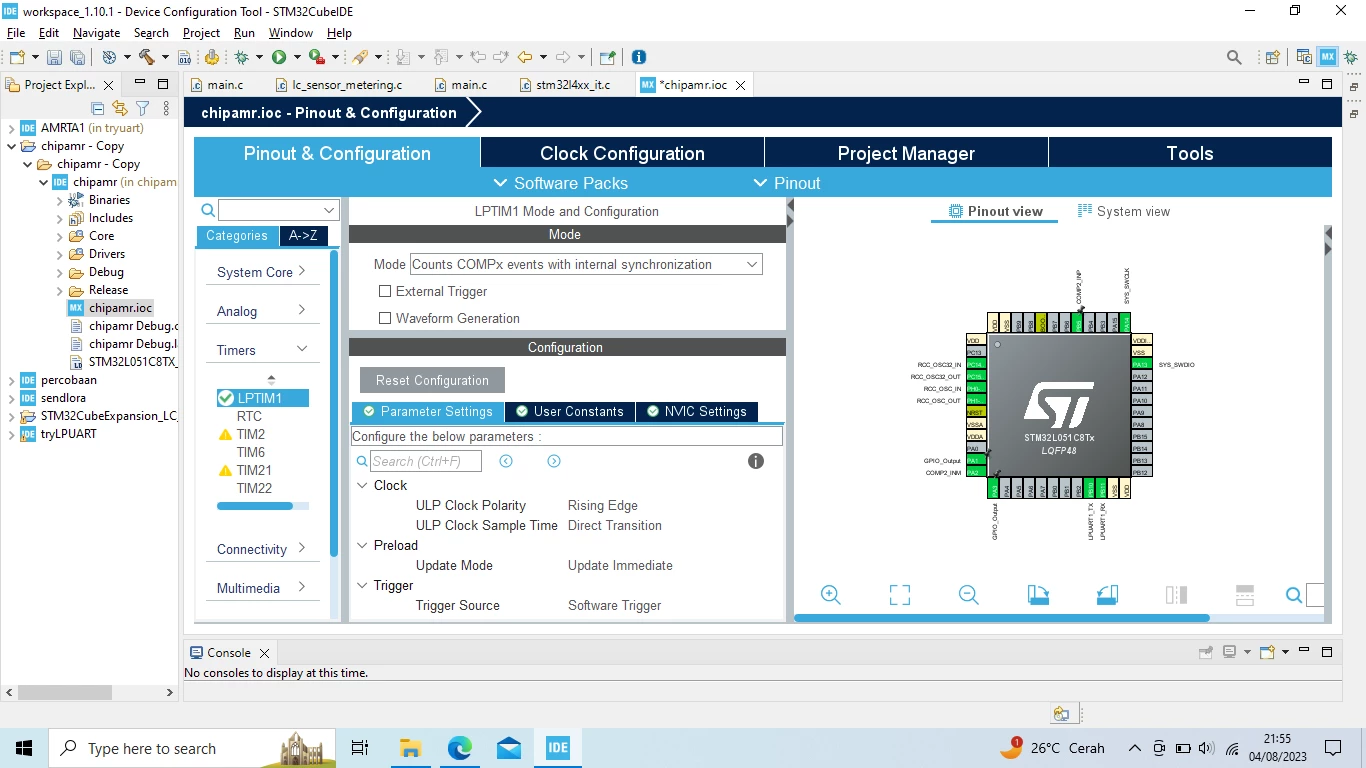

I want to count the pulses coming from COMP2's output using LPTIM1. However, when I send it to Tera Term, the displayed LPTIM value is consistently 1, and it doesn't match the COMP2 output.
Has anyone had this problem? How did you resolve it?
I would greatly appreciate it if there is an expert who can assist in fixing this issue.
I am using STM32Cube IDE Version: 1.10.1.
My MCU is STM32L051C8T, on a custom board

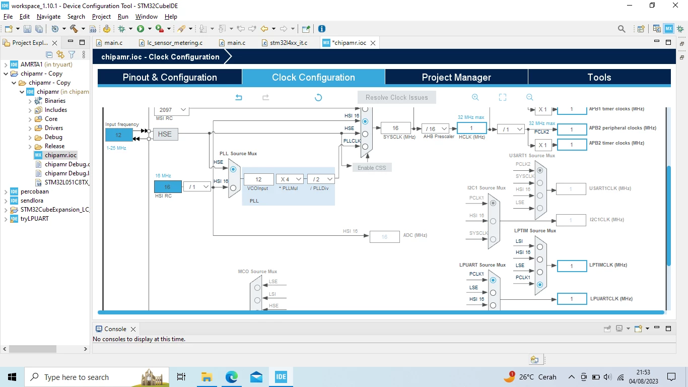

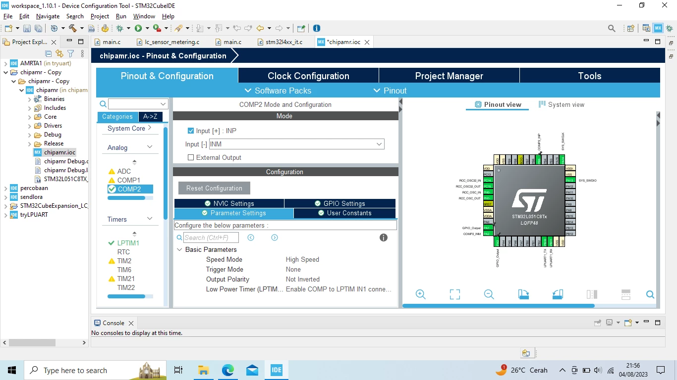

This is my clock
This my LPTIM configuration
this COMP configuration
this my code

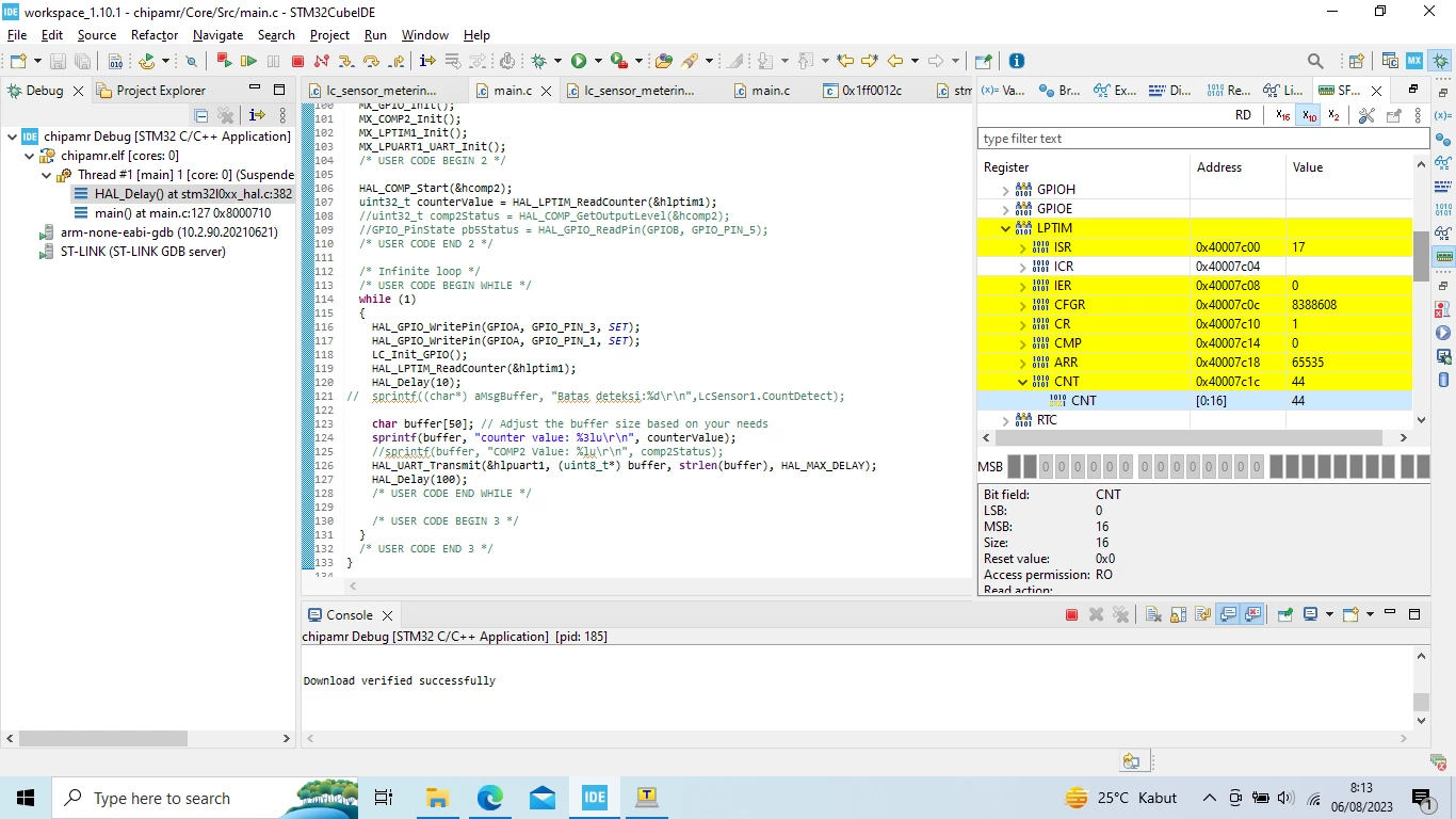

    maybe as a first step, verify that the LPTIM counter is running; read the value of the counter (since it's always showing value 1)
    Valen_idAuthor
    August 4, 2023
    Oh yes I forgot to include it, is this what you mean?

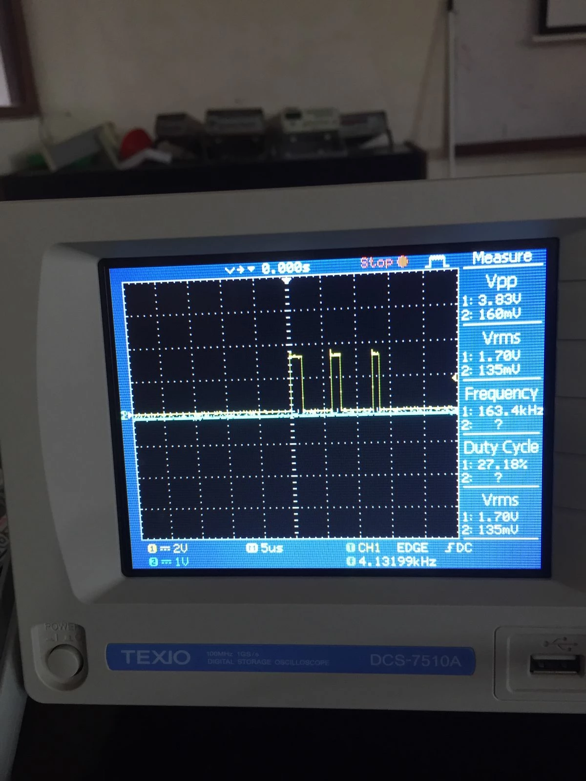

    If I detect it with an oscilloscope, the output on the COMP pin out is like this

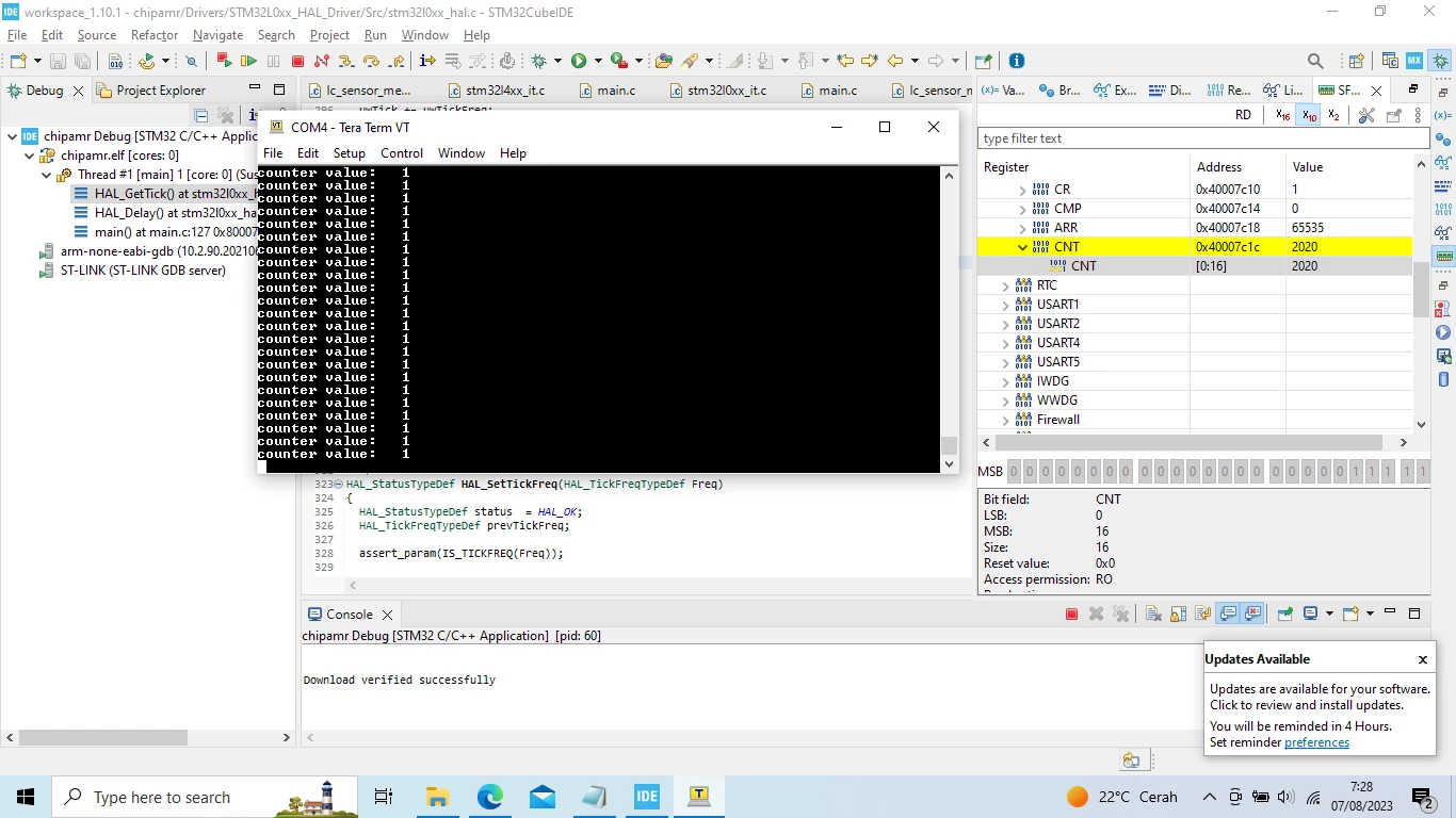

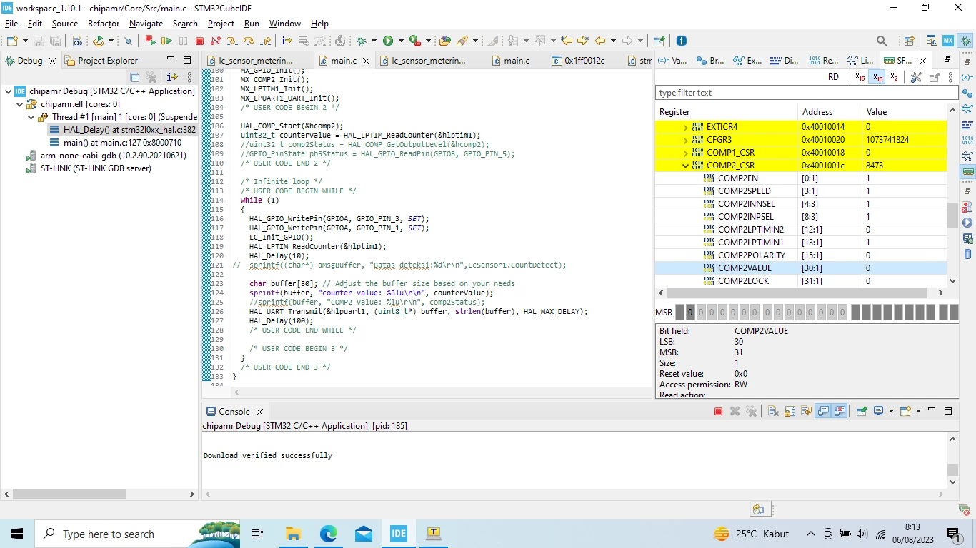

    waclawek.jan
    August 5, 2023
    Read out and check/post content of COMP and LPTIM registers.
    Valen_idAuthor
    August 5, 2023
    Thank you for your reply, how do I get it
    waclawek.jan
    August 5, 2023
    In debugger, you should have some kind of "peripherals view" window or something similar. I don't use CubeIDE so don't know where.
    [EDIT] UM2609 chapter 5 Special Function Registers (SFRs)
    Valen_idAuthor
    August 6, 2023
    Is this what is meant?
    waclawek.jan
    August 6, 2023
    Yes.
    And LPTIM_CNT is not 1 as you've said above.

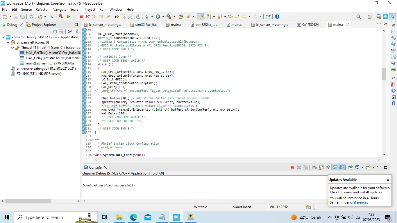

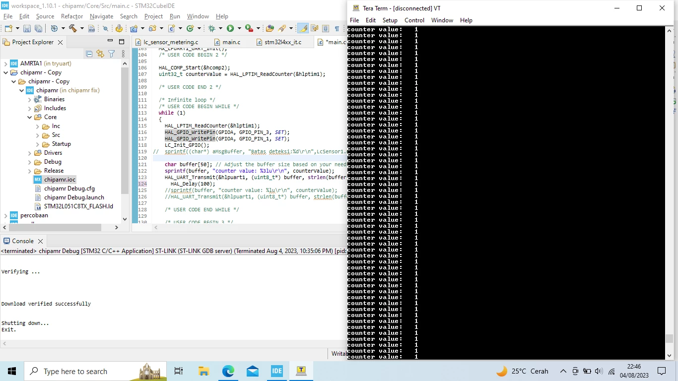

    Valen_idAuthor
    August 7, 2023
    But why my counter value displayed in the serial terminal remains 1, do you know it
    This is my code
    waclawek.jan
    August 7, 2023
    Where do you change the counterValue variable?
    Valen_idAuthor
    August 7, 2023
    Do you mean my variable is on line 107
    waclawek.jan
    August 8, 2023
    Yes. You don't change it in the while() loop.
