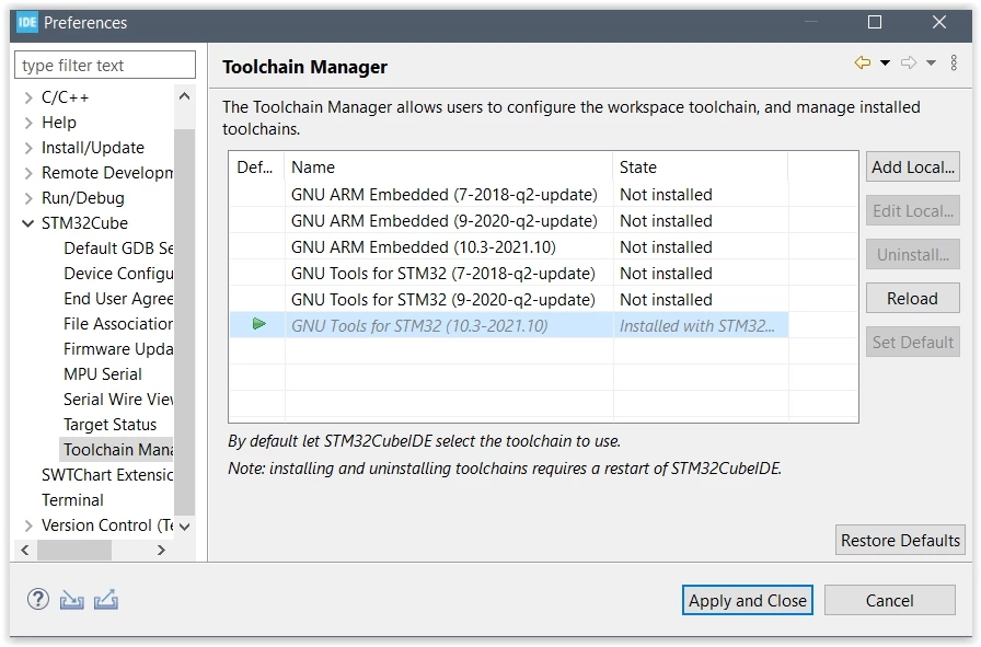

So my gcc cannot be found anymore. Before the deinstall it worked to run the program without any error.
Where do I have to check if the gcc is right connected. The toolchain manager says gcc would be installed by STM by default.
Can anybody suggest or help?

Hello @dachungmao​
I propose that you check if the gcc exist under the installation folder of CubeIDE.
This is the path where I could find the tool in my PC:
C:\ST\STM32CubeIDE_1.10.1\STM32CubeIDE\plugins\com.st.stm32cube.ide.mcu.externaltools.gnu-tools-for-stm32.10.3-2021.10.win32_1.0.0.202111181127\tools\bin
Also if the files exist under that repository try to lunch the GCC via cmd lines.
I suspect that maybe your antivirus system either have deleted the gcc files or have put them in the quarantine.
Kind regards,
Semer.

Checked: same path as yours with content of gcc, cpp, c++ etc. on my PC.
So on my PC I have an extra and useless installation of the toolchain in SysGCC.
In my PATH variable your mentioned path is listed, too.
I did search for all ocurrences of gcc, if there would be an exe, com, bat. But no!
I can call arm-none-eabi-gcc.exe [...] from command line, but why is it invoked as gcc[.exe] by IDE? Obviously my STM32CubeIDE-Installation is complete. But with starting MAKE something goes wrong. Now I could analyze the make file, but I am not an expert! So I need help from a guru of ECLIPSE and STM-Tools.
