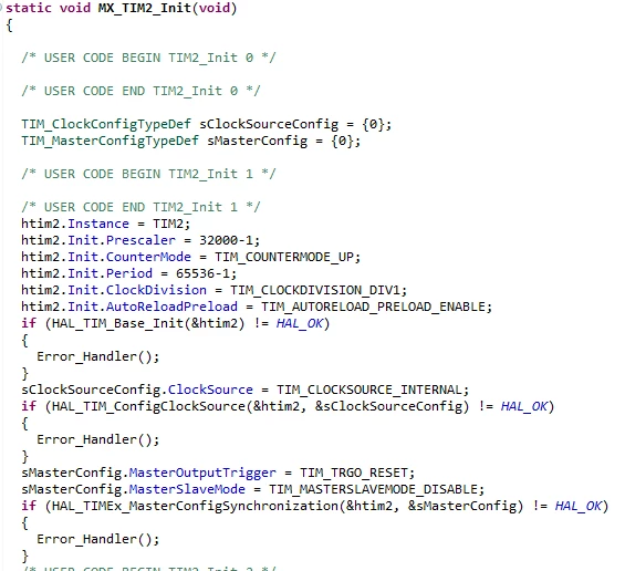

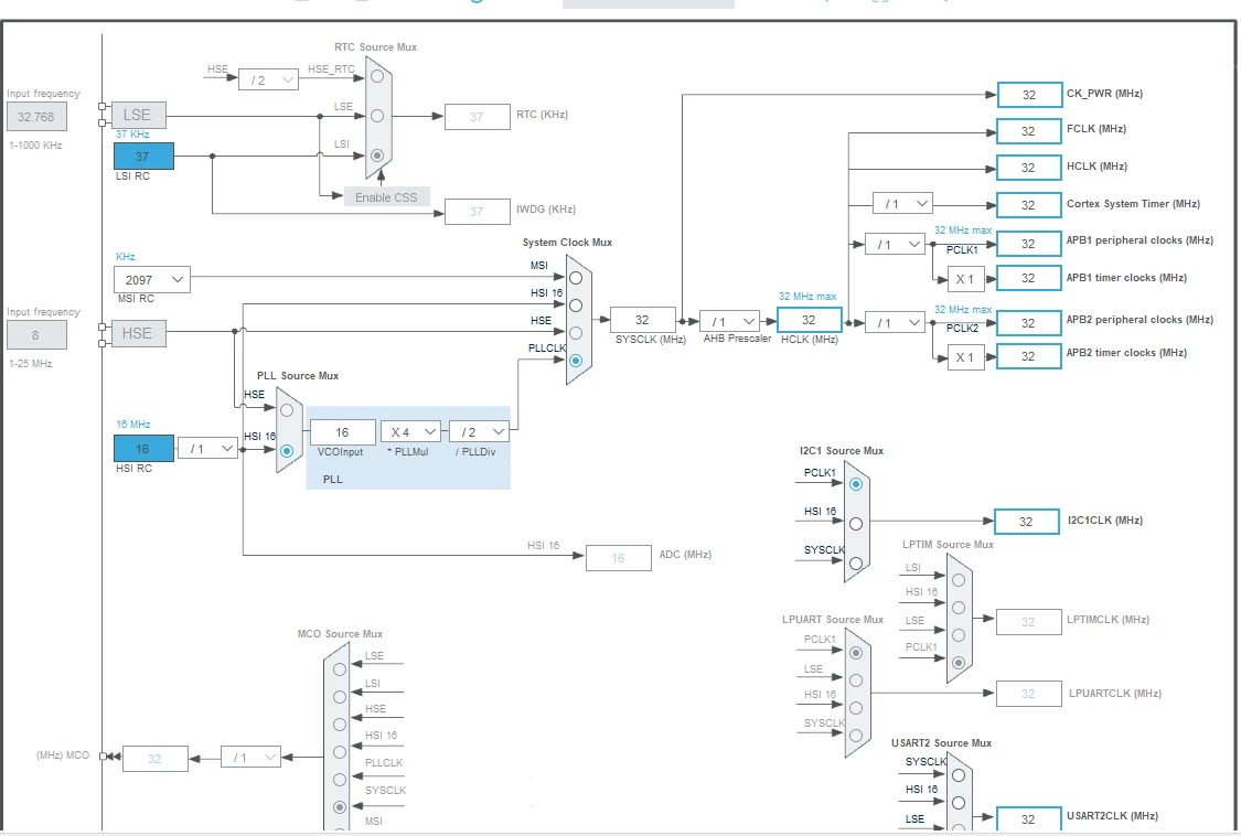

STM32CubeMX clock configuration settings (MCU works at maximum 32 MHz):
Generated Timer init function:
The maximum period I can enter is 65 536 ms (2^16) which is 65.536 seconds. If I enter for example 70 000 then timer interrupts every 5 seconds.
How could I set period to 10 minutes (600 000 ms)?
waclawek.jan
May 25, 2021
Set it to 1 minute (60 seconds), and in the interrupt service routine (ISR) count to 10.

waclawek.jan
May 25, 2021
> But if I use counting, it will act like delay which results in blocking the program.
No.
Simply setup up the timer for the 1 minute period, enable it, enable interrupt, and set a global variable to 10. In the ISR, decrement that global variable, and once it reaches 0, you do your action (temperature measurement). Counting happens only once in a minute in the ISR, the rest of program runs as usually.
