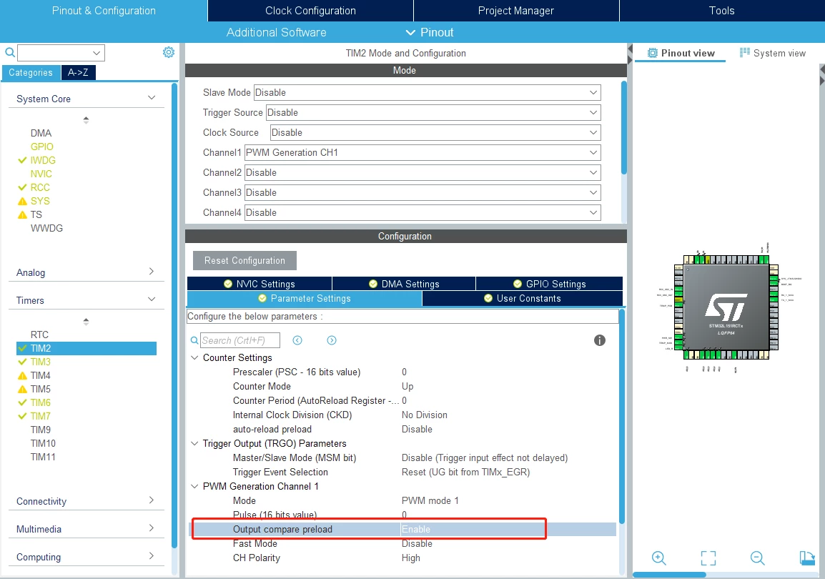

LL library STM32 OUTPUT compare preload pwm setting enable is unsuccessful,May I ask what is the reason?
  • May 14, 2020
  • 5 replies
  • 6396 views
When I set Output compare preload to enable in the configuration interface, the generated code shows disable0693W000001cFw5QAE.png0693W000001cFvvQAE.png

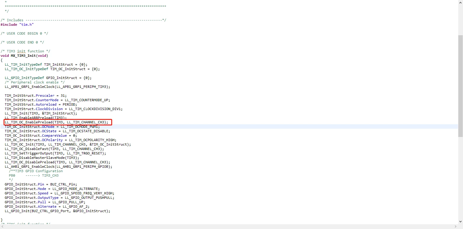

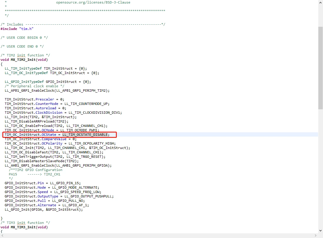

waclawek.jan
May 14, 2020
Look 2 lines higher than is the highlight - there's the preload enable.

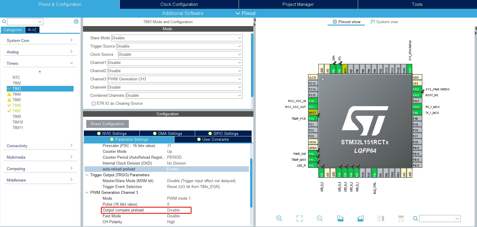

Thank you for your answer. When I set Out put compare preload to disable in Device Configuration Tool, the highlight is still enable. I do n’t know how to configure to change these parameters. Could you tell me if you know?

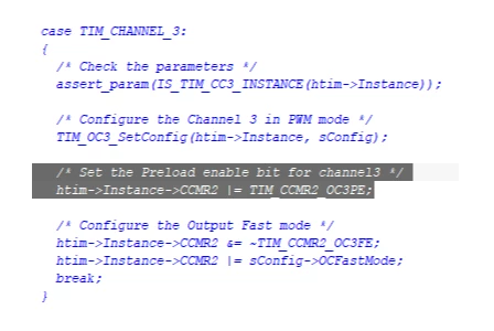

The LL are a translation of the intropack HAL drive. So, if in the function of the driver that you call there is a forcing of this parameter, then it appears in the LL code generation.
In the reference function you would call (if you are in HAL):
HAL_StatusTypeDef HAL_TIM_PWM_ConfigChannel(TIM_HandleTypeDef *htim,
                      TIM_OC_InitTypeDef *sConfig,
                      uint32_t Channel)
There's a call for channel preload.
This is the code you find in LL.
