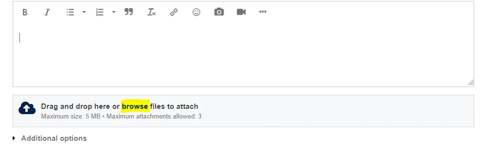

October 19, 2023
Hello @MED2972,
You should click on browse and select the zip file.
Thanks.
