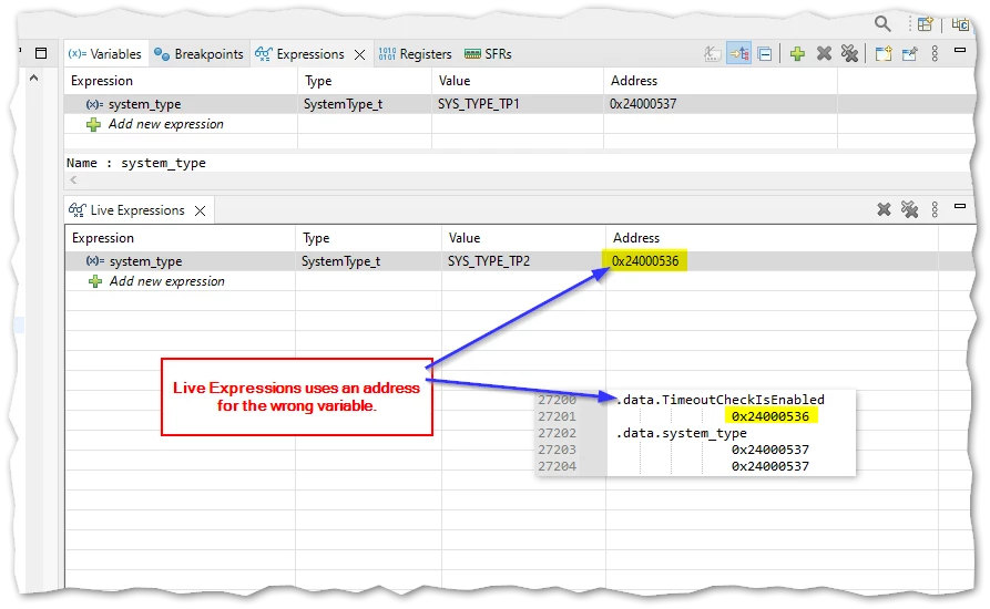

Am using 1.16.0.
This picture tells the whole story:
Am I doing something wrong or is Live Expressions broken?

    I am suspecting an alignment request for live expressions. But after reading that https://community.st.com/t5/stm32cubeide-mcus/live-expressions-showing-unexpected-value/td-p/119158 I am not so sure anymore.

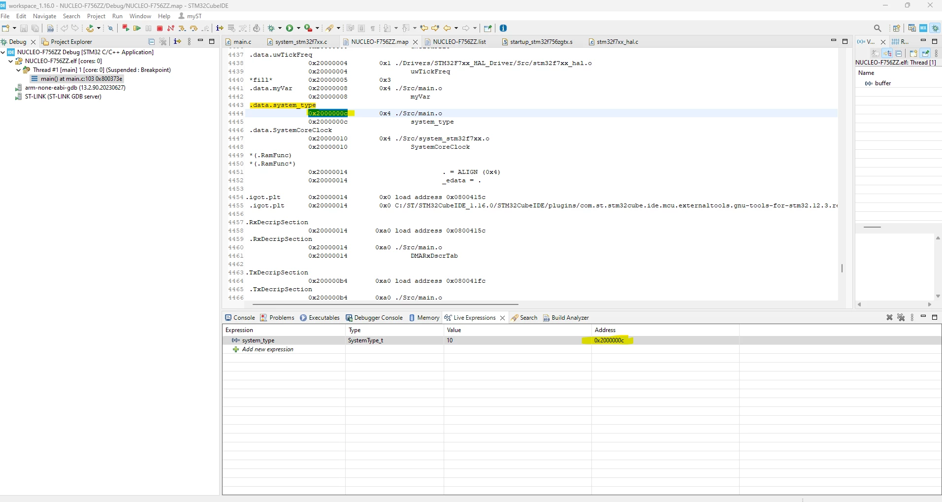

    Hello @Kier and welcome to the community,
    I tried to reproduce the problem with a different variable type, but I couldn't reproduce it. Here is an example in the screenshot.
    To further investigate the issue, could you share the variable type definition you used for this project?
    Thanks,
    Rim.
    Senior III
    July 9, 2024
    @Rim LANDOLSIin your example the address of system_type is aligned on 32-bit boundaries.
    We don't know what is the size of system_type in the original post, but since it was put at an odd address by the linker, it should be 8 bits. @Kier can you give us more info on the variable in use ? Or better yet, make a small project that reproduce the issue ?

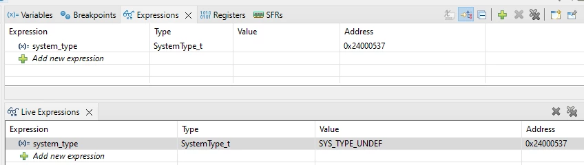

    The variable type in question was an enum:
    typedef enum
     SYS_TYPE_TP1,
     SYS_TYPE_TP2,
     SYS_TYPE_MAX_NUM,
     SYS_TYPE_UNDEF = 0x7F,
    } SystemType_t;
    I'm assuming short enums are used so the underlying type is a char.
    SystemType_t system_type = SYS_TYPE_UNDEF;
    Unfortunately, I can't recreate the problem now. The address (and data) in the same in both Variables and Live Expressions:

    Try deleting all the live expressions and add them again when you are on a breakpoint where the expression variables are in scope. I've had issues with adding a second expression or adding one of a variable out of scope.
