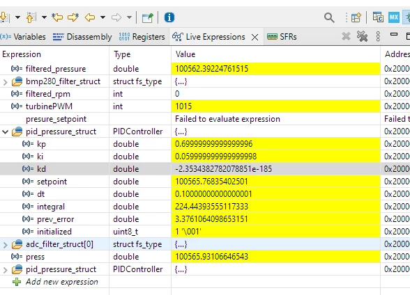

"Live Expressions" bug with "double" type
  • December 5, 2023
  • 2169 views
Hello, ST team.
We are happy to report new bugs, because the old ones have already been resolved)
When I try to edit the value of a variable in the Live View window, the variable of type "double" takes on a random value. Variables of the "float" type are edited without problems and accept the entered valuesю
But if I using popup window to edit structure variables it is working correct with "double" types.
using STM32F411 MCU
1. Trying to edit "pid_pressure_struct.kd" input 0.3, but shows -2.53...e-185

    Hello @olezhandr  and welcome to the community,
    Thank you for your contributions and for your detailed explanations. The issue has been reported to STM32CubeIDE development team. An internal ticket ID 168019(This is an internal tracking number and is not accessible or usable by customers) is submitted to escalate this issue internally to the STM32CubeIDE team .
