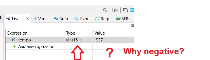

Do someone know how to fix the wrong type format on Live Expression under Debug?
The format is uint16_t which "live expression" understand corretly, but shows  signed int.
Please, see the picture attached.
It was right on old CUBE versions...
Regards.
Best answer by JSILV.2
The issue occurred on Version: 1.13.1 Build: 17479_20230728_0839 (UTC)
But, leading for advices, I will uninstall and re-install my IDE.
Thanks

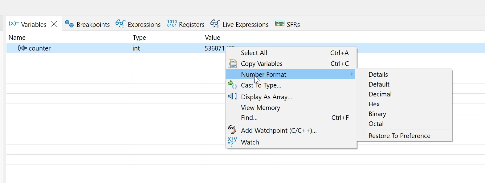

Johi
Senior II
August 15, 2023
Right click on your value gives the option, default or decimal. (default is unsigned representation)
Rim LANDOLSI
August 15, 2023
Hello @JSILV.2 ,
The issue is not reproduced  on the newest STM32CubeIDE version. Could you, please, provide which STM32CubeIDE version and MCU used for this project.
Thanks,
Rim
JSILV.2
JSILV.2AuthorBest answer
August 15, 2023
Thanks
JSILV.2
JSILV.2Author
August 15, 2023
Issues, solved.
Thanks.
