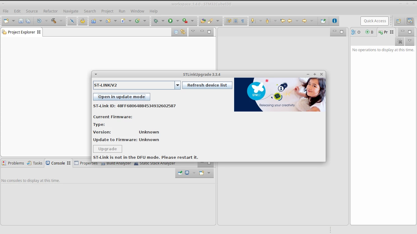

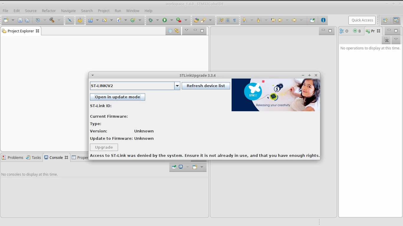

After installing Linux Ubuntu, I installed STM32CubeIDE 1.4 and this message appeared when trying to access the firmware update:
"Access to ST-Link was denied by the system..."

 st-stm32cubeide-1.4.0 : Depends: ca-certificates-java but it is not going to be installed
E: Unmet dependencies. Try 'apt --fix-broken install' with no packages (or specify a solution).
That has been fixed with the suggested command (apt --fix-broken install):
done.
done.
Setting up st-stm32cubeide-1.4.0 (1.4.0-7511-20200720-0928-1) ...

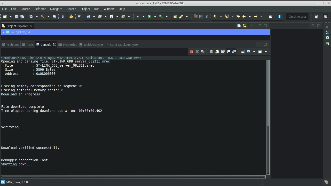

After performing all commands correctly in the post about driver installation, ST-Link was recognized correctly by the IDE.

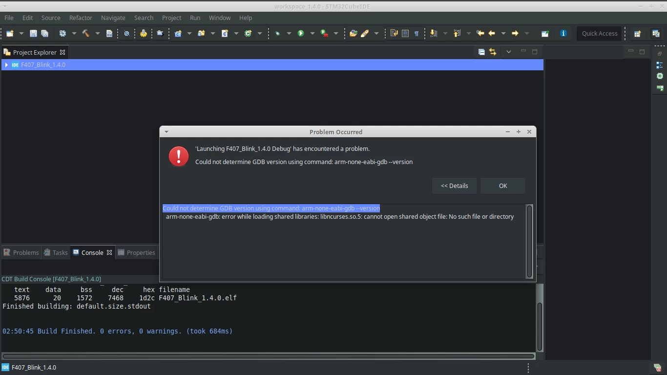

Another error then occurred:
Could not determine GDB version using command: arm-none-eabi-gdb --version...
Solved with the command:
sudo apt-get install libncurses5
Source:
https://stackoverflow.com/questions/39831575/could-not-determine-gdb-version-after-sending-arm-none-eabi-gdb-version-resp
On Ubuntu 23.04 I encountered the same problem, but `libncurses5` cannot be installed anymore.
New Solution:
`sudo apt install gdb-multiarch`
And then go to "Window" -> "Preferences" -> "Toolchain Manager" -> "Add Local" and set it up like this:
Then "Set Default" on this new entry.
