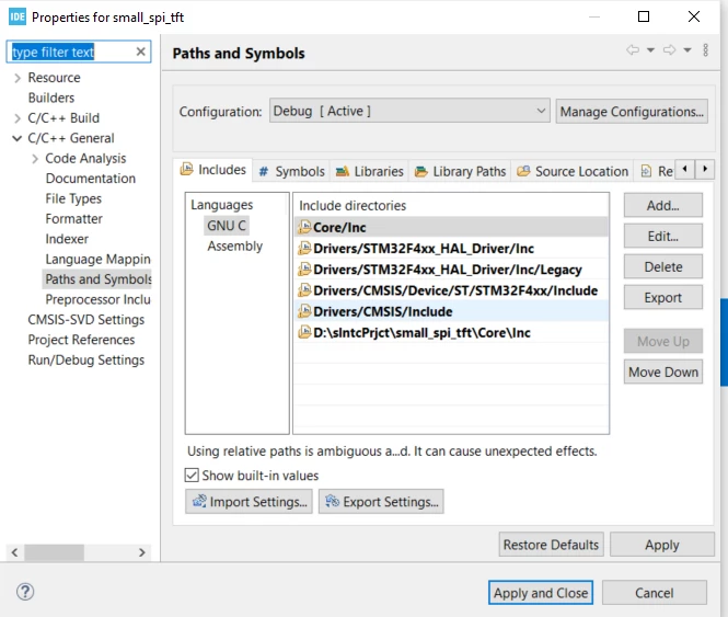

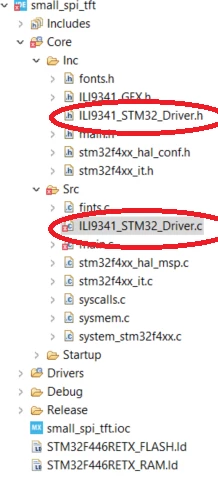

Hi @Community member​ , you're always there for our rescue. Please note the following:
1- Expect that you will need to #include the .H -> included
2- If those are in current include paths the compile should find them. -> in the path
3- Source behind the functions needs to be added via the project tree view.-> yes
0693W00000NskK2QAJ.png4- The error is coming from the Compiler or the Linker? -> error message:
d:\st\stm32cubeide_1.9.0\stm32cubeide\plugins\com.st.stm32cube.ide.mcu.externaltools.gnu-tools-for-stm32.10.3-2021.10.win32_1.0.0.202111181127\tools\arm-none-eabi\bin\ld.exe: ./Core/Src/ILI9341_STM32_Driver.o: in function `ILI9341_DrawHollowCircle':
D:/slntcPrjct/small_spi_tft/Debug/../Core/Src/ILI9341_STM32_Driver.c:23: undefined reference to `ILI9341_DrawPixel'

You've nailed it...My mistake ... I've copied the wrong body of "ILI9341_STM32_Driver.c" that together with adding the "ILI9341_GFX.c" everything compiled successfully.
