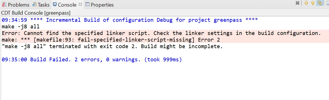

I created a project with CubeIde for the nucleo144 board. I managed the pins for my specific configuration, I inserted files already created externally to perform functions but at the time of compilation I get this error
Cannot find the specified linker script. Check the linker settings in the build configuration.
but in the configuration I have not touched anything from the initial creation of the project and its first compilation.

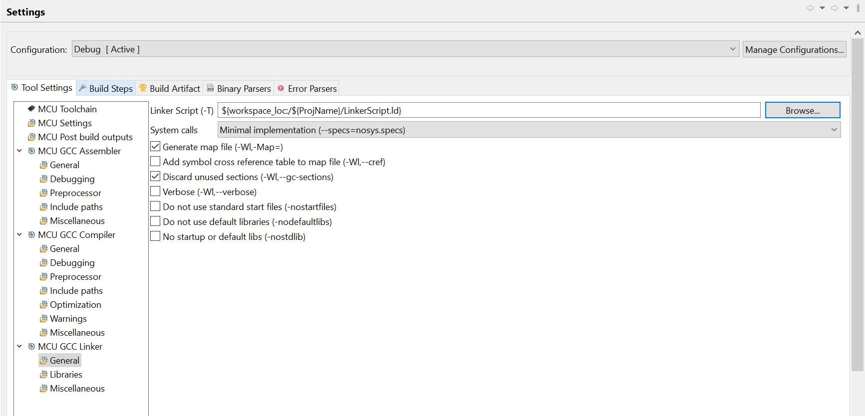

​Hello @Icont.1​ ,
Make sure that you have the correct linker script path.
You should set properly Under "Linker Script" the right path in CubeIde (Properties->C/C++ Build ->Setting ->Tool Settings->MCU G++ Linker ->General).
You can share a screenshot if your issue is not resolved.

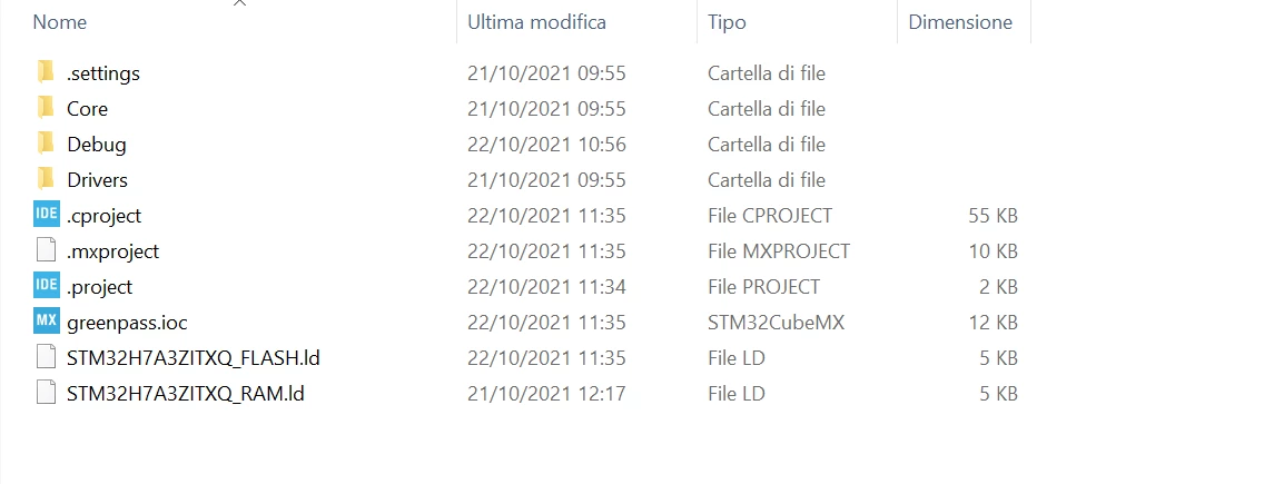

the screen of the setting is this but in the project folder I have no reference to anything about the linker. Which file or folder should I go to recover and insert to fix the problem?0693W00000FDQnjQAH.png0693W00000FDQm2QAH.png
TDKBest answer
October 22, 2021
The two *.ld files are linker files. By default, it should be using the one that ends in _FLASH.
Including the full error message would be helpful. The linker command will specify the filename it's using and trying to find.

thanks I solved by manually setting as linker the file *.ld (FLASH) from the settings.
