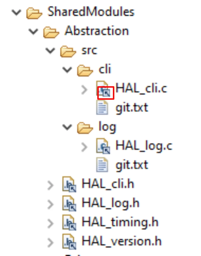

> I would like for the IDE to somehow make easy for me to know that the file I am currently viewing is a linked file.
The IDE indicates linked files by small arrow overlays on the icons:
The resolved location of linked file can be seen in Properties-> resource.

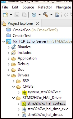

Thanks for replying Pavel.  Unfortunately, my IDE is not showing the yellow:
I'm using revision 1.18.0 of the IDE.
Karl Yamashita
Principal
Mar 31, 2025 6:40 PM UTC
@Pavel A.  was highlighting the little squares with the arrow pointing to the upper left corner.

Pavel A.
Apr 1, 2025 8:26 PM UTC
To find the active file in the editor in the Project manager view: right click anywhere in the editor, Show in -> Project explorer.
Show in -> System explorer will open the Windows explorer (or Nautilus, etc. in Linux) and focus on the file on the disk.
