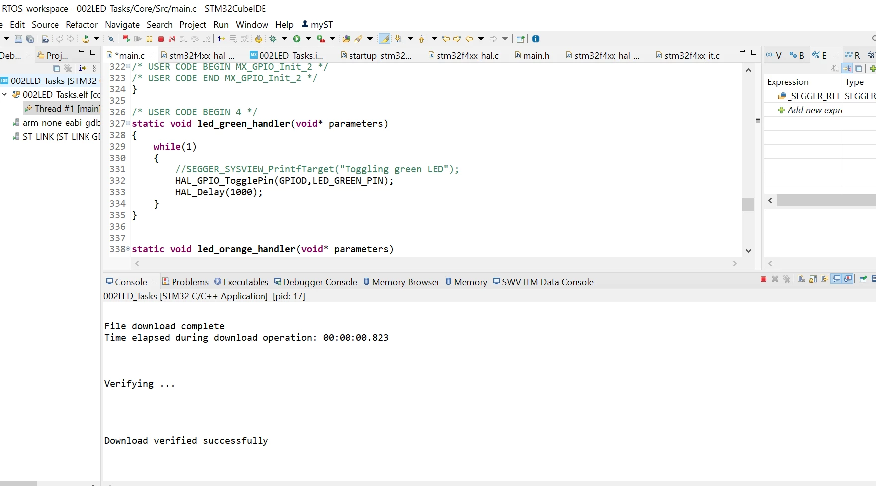

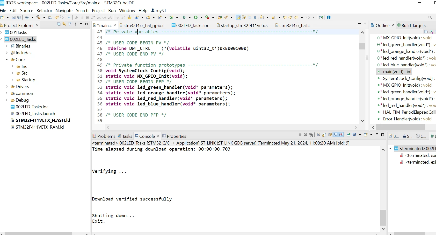

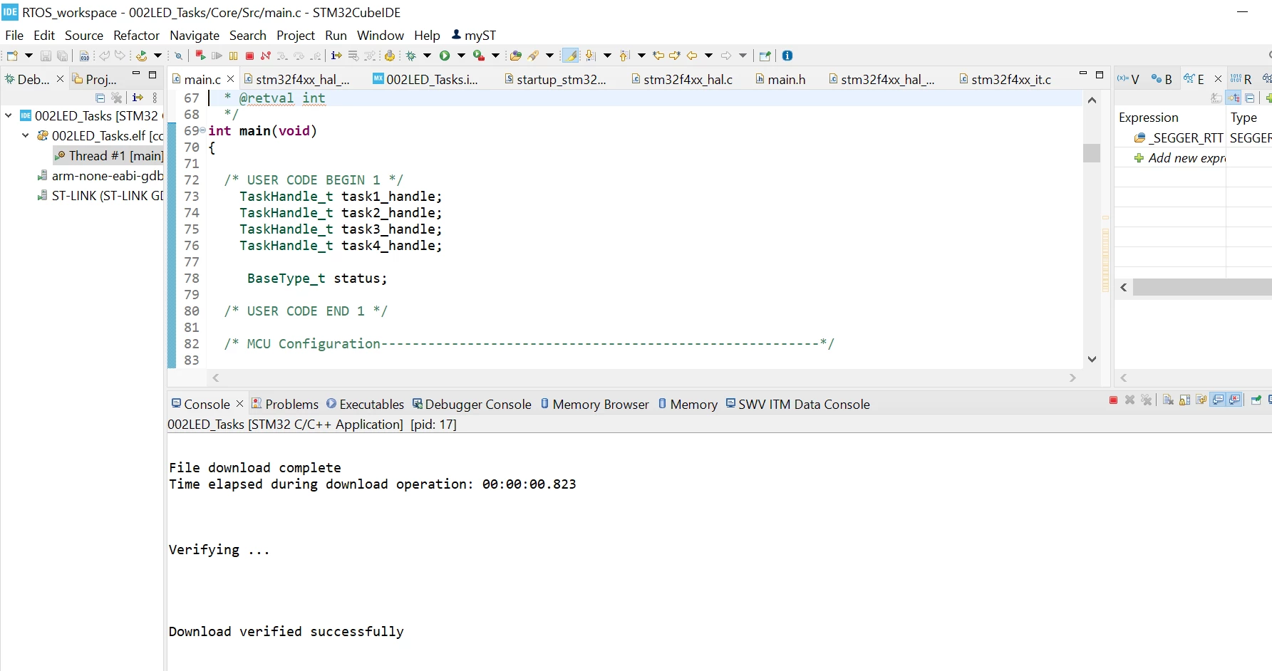

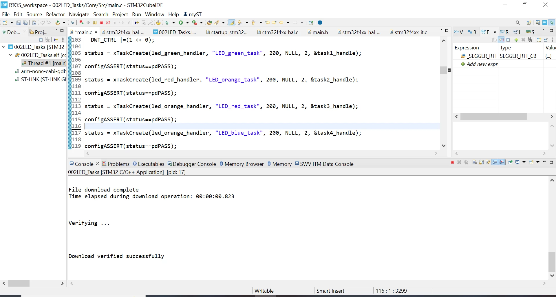

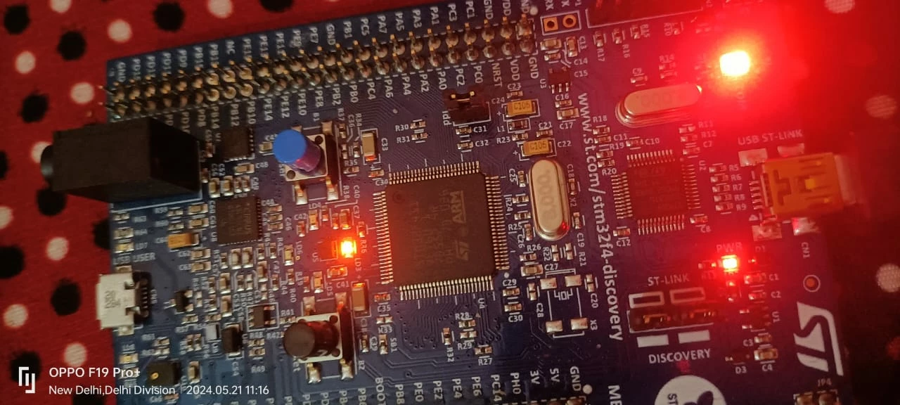

I built a project in STM32F411E-DISC . project is built successfully and also  when we debugged no issue is found ,but after debugging only ORANGE LED is toggling rest 3 LED is not toggling . kindly help me to resolve this issue .kindly  find for code and microcontroller.WhatsApp Image 2024-05-21 at 11.16.40 AM.jpegCapture-3.PNGCapture-2.PNGCapture-1.PNGCapture.PNG

    Are you sure you’re configuring the right GPIOs?
    Enabled RCC clock for the GPIO ports?

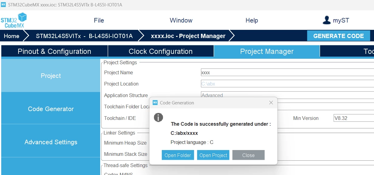

    arunodayAuthor

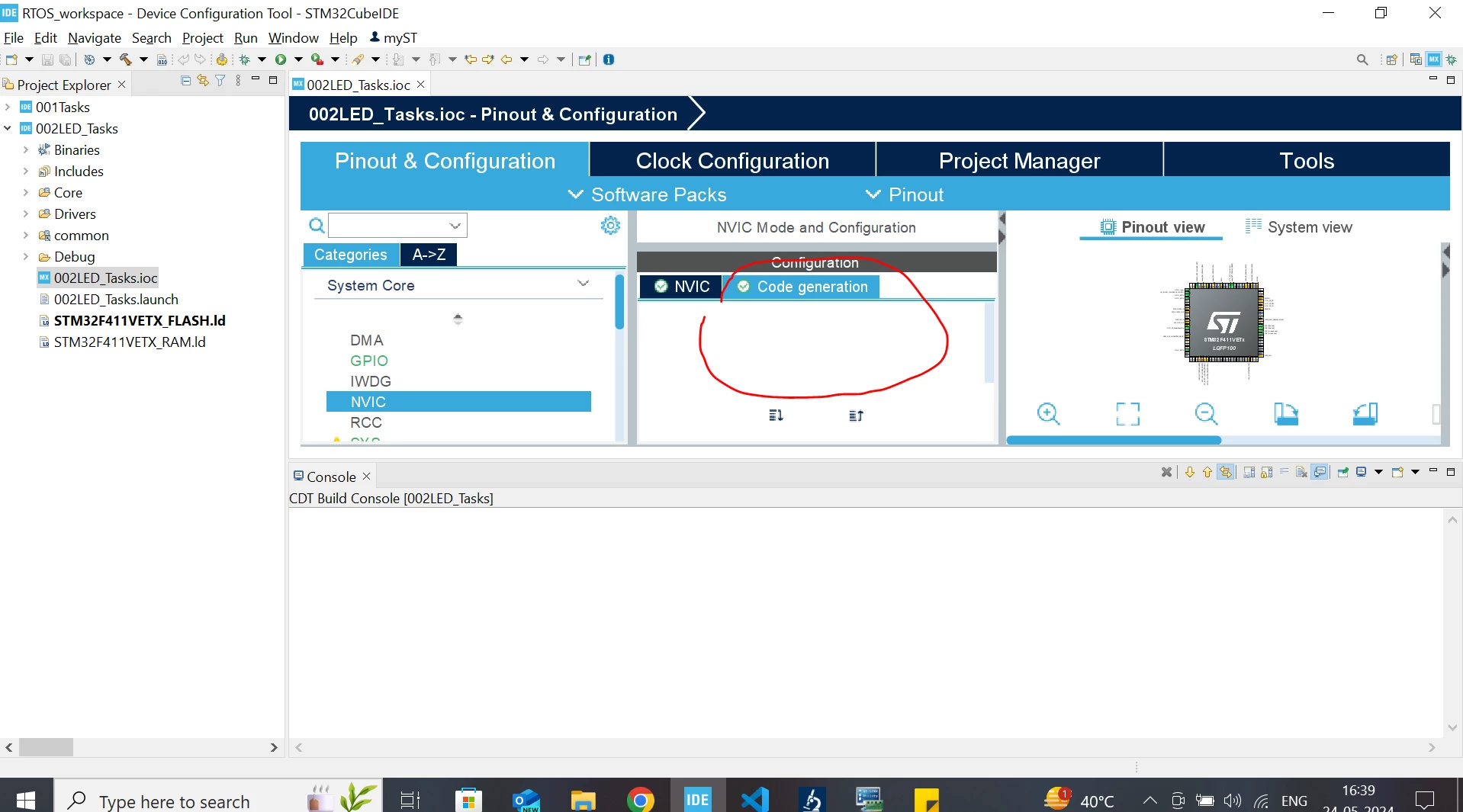

    why  code generation section is blank . i build 2 project but still in both project code generation section is blink , how to resolve this issue Capture-4.PNG
    refer to the snapshot, and Click the Right-Top Corner to generate the Code.
    The one you have circled up is to setup the parameters.
    Alternatively,
    Refer to the attached file,
    follow the steps from page 38.
