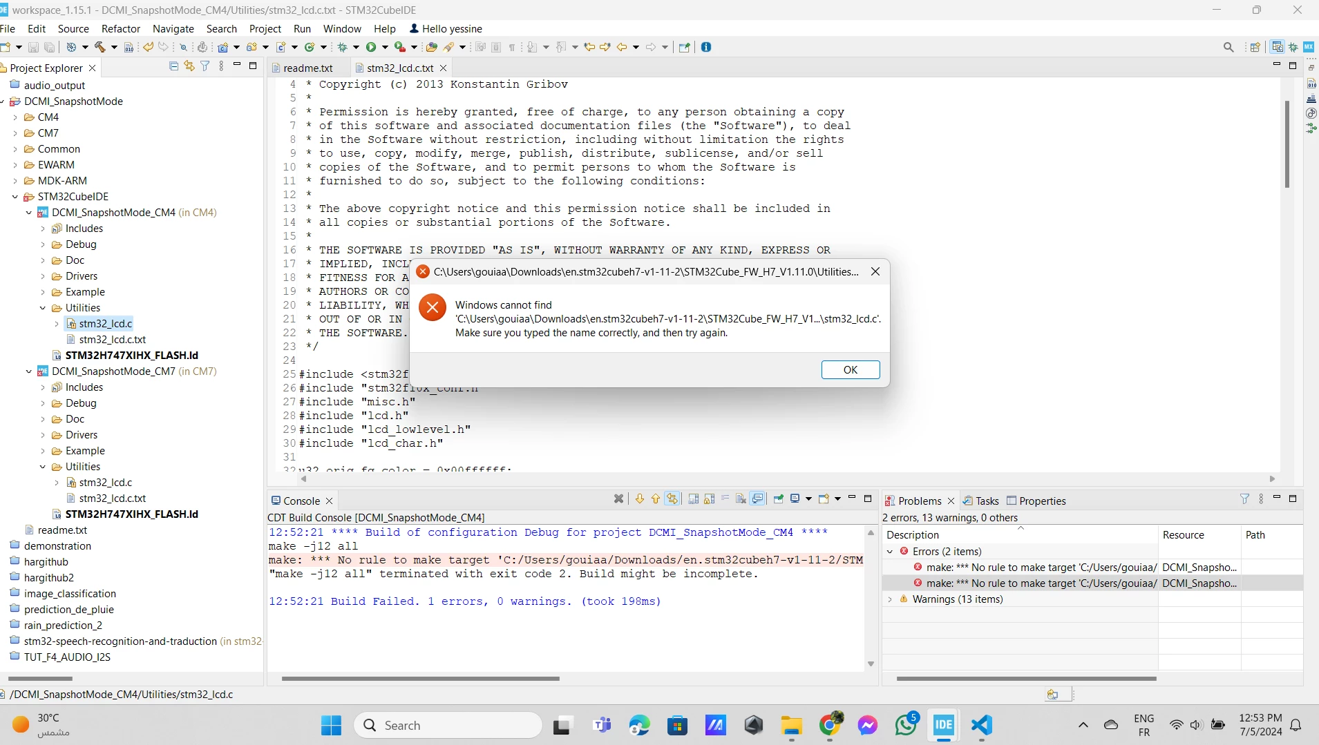

so im trying to run a project example from the stm32h747i disc0 repository from github. specifcally the DCMI project i want to try the camera using snapshot mode or capture mode .when i pen the project and try to build it  i gave this error saying that the lcd.c file is not found in project files(Description Resource Path Location Type
make: *** No rule to make target 'C:/Users/gouiaa/Downloads/en.stm32cubeh7-v1-11-2/STM32Cube_FW_H7_V1.11.0/Utilities/lcd/stm32_lcd.c', needed by 'Utilities/stm32_lcd.o'. Stop)
and the file really doesnt exist in this path when i cheked th project folders.  any help please?Screenshot 2024-07-05 125336.png

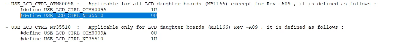

    To make work the DCMI_CaptureMode example with MB1166 Rev-09, it is recommended to use the latest STM32Cube_FW_H7_V1.11.2 version and change the code lines in stm32h747i_discovery_conf.h file under STM32Cube_FW_H7_V1.11.2\Projects\STM32H747I-DISCO\Examples\DCMI\DCMI_CaptureMode\Common\Inc as mentioned in readme

    I checked the DCMI project available in the STM32Cube_FW_H7_V1.11.x and it works properly.
    Please check the include path and make sure that it is included in your source folders:
    Project properties -> C/C++ General -> Paths and Symbols -> Source Location.

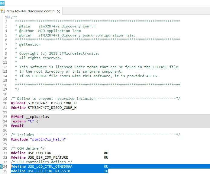

    i managed to run the project . i used the folder that was downlaoded automatically when i selected the board the first time in MX. now i have an other problem. the snapshot mode worked perfectly but the capture mode didnt . when i checked the readme file i found this configuration that i need to do since im using a rev09 camera but i couldn't manage to do it  . so is there any guide to help me so this adaptation. in which file i can find these lines of code...Screenshot 2024-07-16 105415.png

    and for capture mode i just needed to change a line in some config.h file    (change nt**** to OU  from 1U and  and om**** from 1U to OU)
