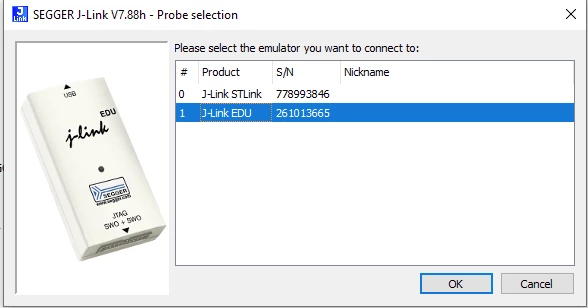

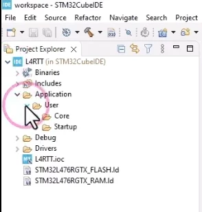

I would like to know How to configure the J-LINK Segger to work with STM32CubeIDE, after a little searching I found this video : https://www.youtube.com/watch?v=Rf-NKOoPYUc
But at 12:11 I can see this configuration in the video
But I don't have an Application directory :
In this case, do you have an idea how to do it ? Thank you for your helps.

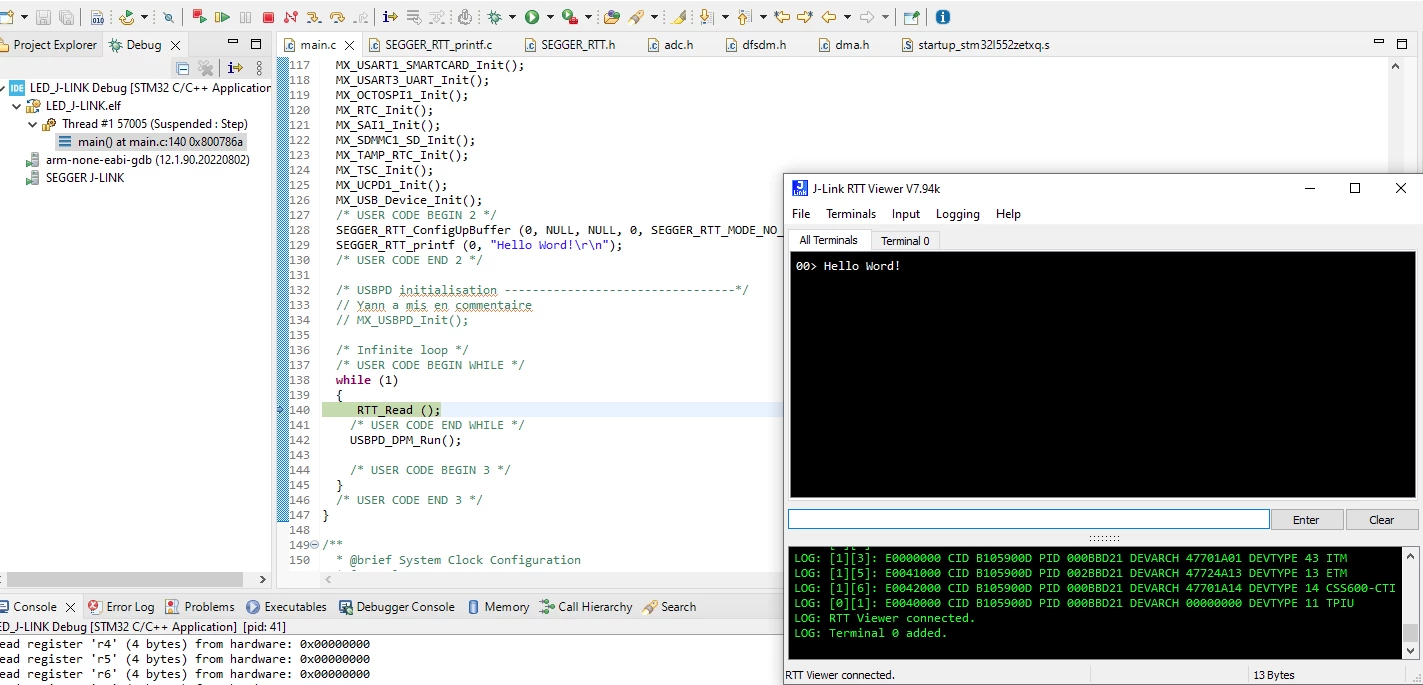

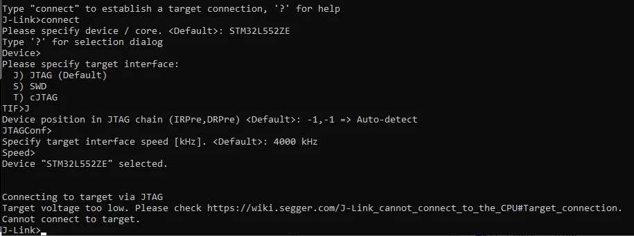

Your video is about how to set up RTT -  a Segger proprietary feature which works over the basic SWD hardware connection.
This error message:
tells you that it's the basic SWD hardware connection that's failing - it hasn't got as far as anything to do with RTT at that point!
@DYann.1 wrote:
Yes I have already made the evaluation card work with J-LINK but with USB_STLK, but for my projet I've another card that doesn't have US_STLK (for consumption and card size).
So which one is giving the connection error - the EV board, or your custom board?

@Andrew Neil wrote:
This error message:
Yes you're right but I have already configured the tool now I will check again to see what it gives. After checking nothing is works
that I try to connect via SWD or JTAG nothing works, so it is normal that STM32CubeMX cannot communicate with the J-LINK
Andrew Neil
So this is not about the tool configuration - it is a basic hardware problem:
Are you also going to complain to Segger about giving you "useless" (sic) links?
When the basic hardware connection is not working, nothing which needs to use that connection can work!

Andrew Neil
@DYann.1 wrote:
I still have to connect USB_STLK even if I don't use ST-LINK (from what I understand).
I'm not clear what you mean by that?
What do you mean by "USB_STLK" here?
You can only have one debug probe attached at a time.
Is this on the EV board, or your custom board?
Show  diagrams.

On my EV board first after I can switch to my real board. "USB_STLK" look on the evaluation card where the connector is located "USB_STLK"
