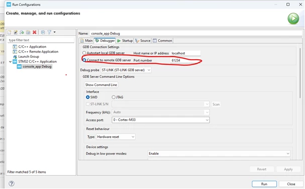

  • 1. If you click on Show Command Line in the Debugger configuration it shows you what is invoked, it launches the gdb server + the cube programmer.
    • C:\ST\STM32CubeIDE_1.8.0\STM32CubeIDE\plugins\com.st.stm32cube.ide.mcu.externaltools.stlink-gdb-server.win32_2.1.400.202404281720\tools\bin\ST-LINK_gdbserver.exe -p 61234 -l 31 -v -d -s -cp C:\ST\STM32CubeIDE_1.8.0\STM32CubeIDE\plugins\com.st.stm32cube.ide.mcu.externaltools.cubeprogrammer.win32_2.1.400.202404281720\tools\bin -m 0 -g
  • You have the option of launching them from windows power shell by selecting ‘Connect to remote etc..). In this way stm cube ide will only do the gdb client part, i suppose.
  • In the folder shown by the commands (the plugins folder) you can find the gdb server and programmers of previous STMCUBE IDE releases, for example in the image below the stmcube programmers bundled with stm cube ide 1.15.1 and 1.16, are respectively programmer 2.16.0 and programmer 2.17.0ALong4_2-1721126638134.png
  • Launching the new gdb server with the old stm cub pregrammer from powershell: it works and flashes, here is the command:
    i C:\STM32Cube_1.8.0\STM32CubeIDE\plugins\com.st.stm32cube.ide.mcu.externaltools.stlink-gdb-server.win32_2.1.400.202404281720\tools\bin\ST-LINK_gdbserver. exe -p 61234 -l 31 -v -d -s -cp C:\STM32CubeIDE_1.8.0\STM32CubeIDE\plugins\com.st.stm32cube.ide.mcu.externaltools.cubeprogrammer.win32_2.1.201.202404072231\tools\bin -m 0 -g
