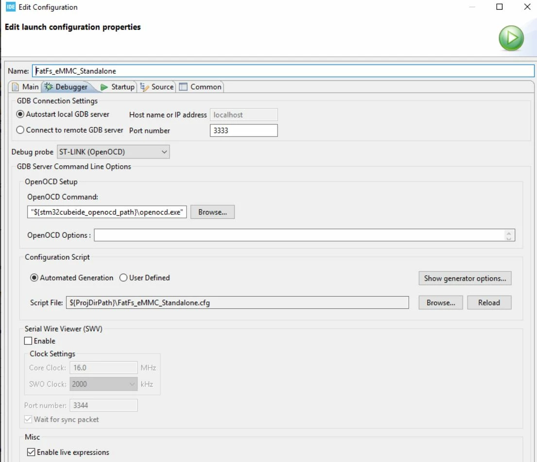

I just received an STM32L4P5 Discovery board to evaluate eMMC for the STM32L4. In the firmware package for the STM32L4 there is an example project, "FatFs_eMMC_Standalone". I have built the example, however, when I try to run it the application halts in "initialize_monitor_handles". (SIGTRAP Trace/Breakpoint Trap)
Seems there is perhaps an option missing in the project, can anyone help me to resolve this please.

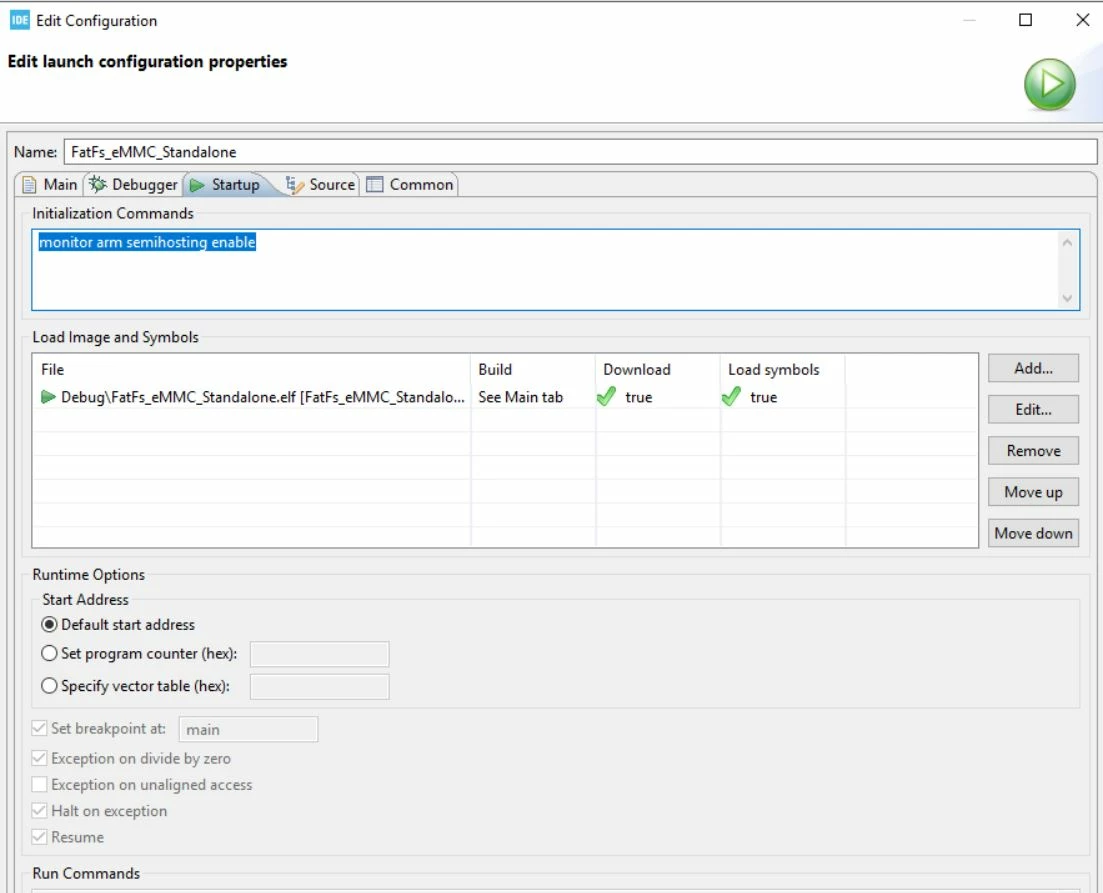

You are right, I reproduced this issue with FatFs_eMMC_Standalone example, using STM32Cube_FW_L4_V1.16.0 and STM32CubeIDE v1.5.0.
This example doesn't work on STM32CubeIDE, as there is a debugging issue on the semihosting configuration while calling the initialise_monitor_handles() function.
As workaround, I updated the Debug configuration in STM32CubeIDE as follow:
1- Use and configure ST-LINK (OpenOCD).
2- Add the command "monitor arm semihosting enable" into startup Initialization commands .

Thanks for pointing out this issue, I have passed it along to our development team for fix.

@Imen DAHMEN​ Thanks you, this was the work-around I got from a case I opened and it is a great work-around.
I look forward to an updated CubeIDE so that I may continue using GDB server.
