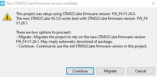

Your shared file is F4 based not F1 ?
Anyway let' assume such F4 file is right one.
If IDE 1.6.1 I'm getting 1.26.0 FW pack usage.
Opening now such project based on IDE 1.7.0 I'm getting dedicated popup dialog asking me if I want to remain on 1.26.0 FW package or to migrate to 1.26.1 new one.
0693W00000D0zrIQAR.jpgBoth migrate or continue paths are working fine on my side

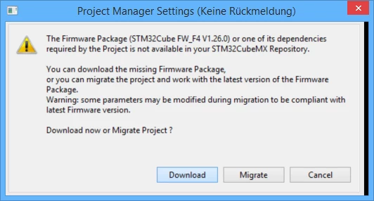

MWiel.1
MWiel.1Author
July 29, 2021
My bad I selected the wrong ioc files, attached to this the one for the STM32F107 project.
But I just checked how the STM32F407 project behaves and for me I'm stuck again
0693W00000D0zwmQAB.pngCould it be related to Windows 8.1 or the firewall/security suite?
Cartu38 OpenDev
Graduate II
July 29, 2021
I'm Win10 based.
If IDE 1.7.0 could you have a try to do "File > New > STM32 Project from an existing STM32CubeMX configuration file (.ioc)" ?
MWiel.1
MWiel.1Author
July 29, 2021
that seems to work but shortly before the above dialog, I see a dialog pop up with the CubeIDE/CubeMX Icon.
