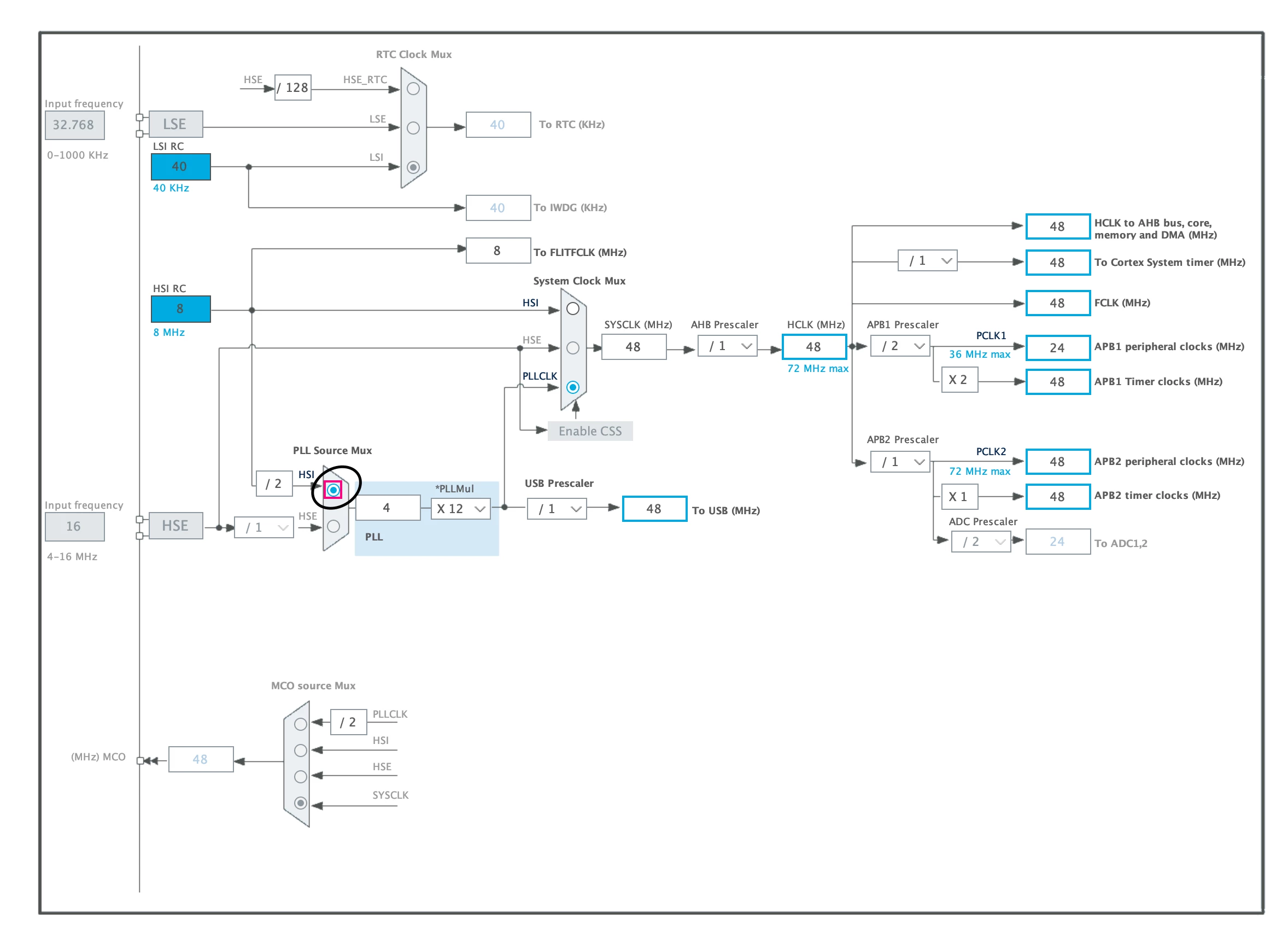

Well, thank you very much. You kinda saved my life. The below configuration seems to be working, the LED is flashing as it should. The only problem it finds is at the point which is circled.
Is there maybe a way to fix this one as well ?
