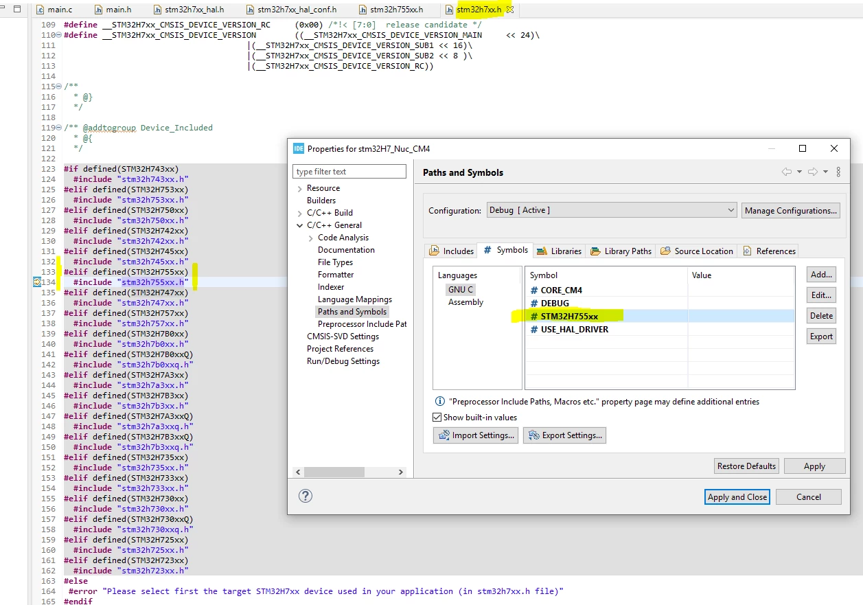

I'm having issue configuring STM32CubeIDE to properly index the include files on a STM32H7 dual core project.
Essentially I created a project using CubeMX v6.2.0. After the project is created I use STM32CubeIDE to build the project. Everything seems to build fine.
While looking at the code, I notice that the IDE seems to think that "STM32H755xx" is defined and therefore gray out the line "#include stm32h755xx.h".
This is not true because "STM32H755xx" is defined in the "Paths and Symbols" section of the project properties.
(see the attached image).
I can't seem to be able to tell the IDE otherwise.

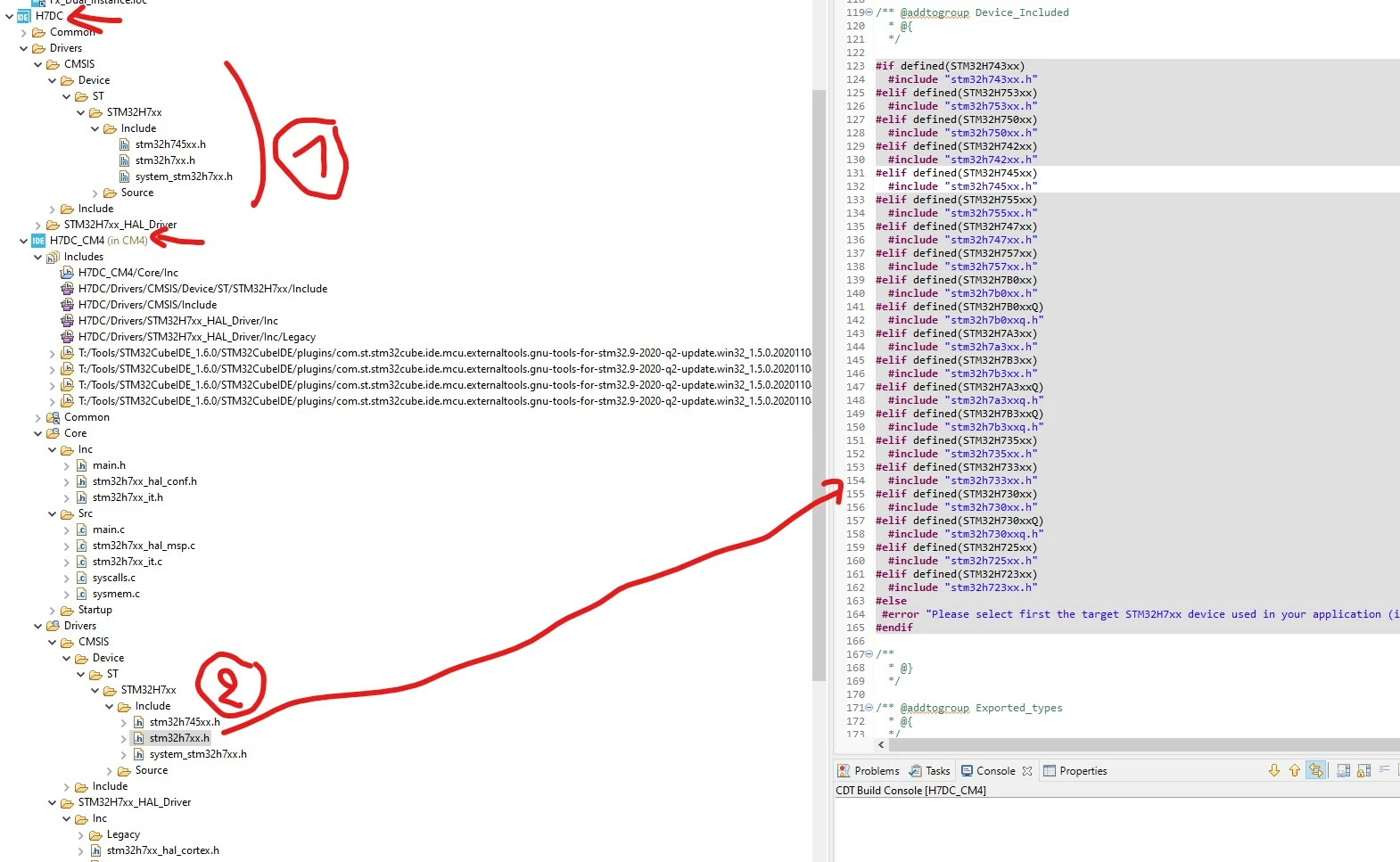

Playing with complex target device (multi cpu here) you are exposed to a hierarchical project structure. You have a top most project which is not a CDT (C/C++) project but kind of repository to host x2 (one per cpu suffixed so _CM4 & _CM7) C/C++ projects.
Your're looking at file located at (1). Such is "common" to both C/C++ projects but hosted as part of top most project. This way Eclipse + CDT are not able to run properly file indexer on. Such feature is only working within same project context.
I've got try to copy (1) to (2) so from top most repository to CM4 dedicated project. Let's look at ... editor is promoting expected highlight then.
Some drawback so of code dupes prevention I guess ...
