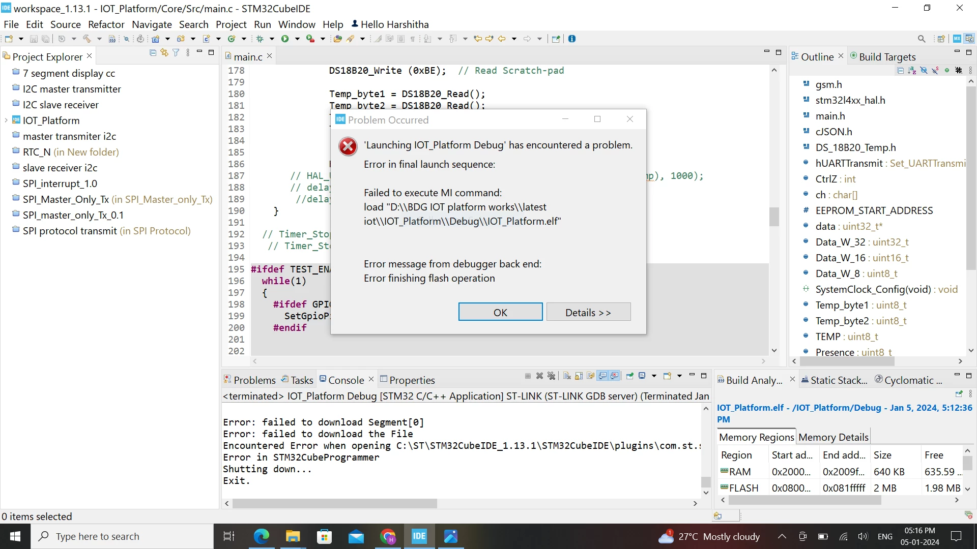

While im trying to flash the code im getting this error
Error in final launch sequence:
Failed to execute MI command:
load "C:\\Users\\C\\Downloads\\RTC_N\\RTC_N\\New folder\\Debug\\RTC_N.elf"
Error message from debugger back end:
Error finishing flash operation
For this i tried some solution provided by community people:
 the above solution is not resolved my issue

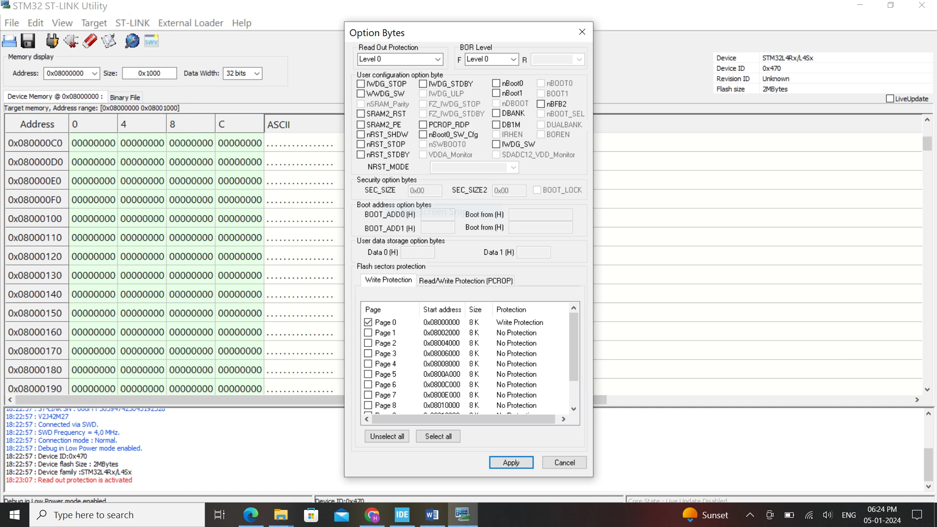

2.You have to install STM32 ST-Link Utility and erase with it the whole flash memory. After that, update the firmware on the board again.
i installed the ST-Link Utility and im trying to erase flash memory but im getting an Read out protection is activated message to resolve this i got an solution i need to change option byte configuration but i dont know the correct configuration for to change read out protection level 1 to read out protection level 0.
for the reference i attached the option byte configuration
and im looking any other possible solution to resolve this issue so please reply or attach any solution links

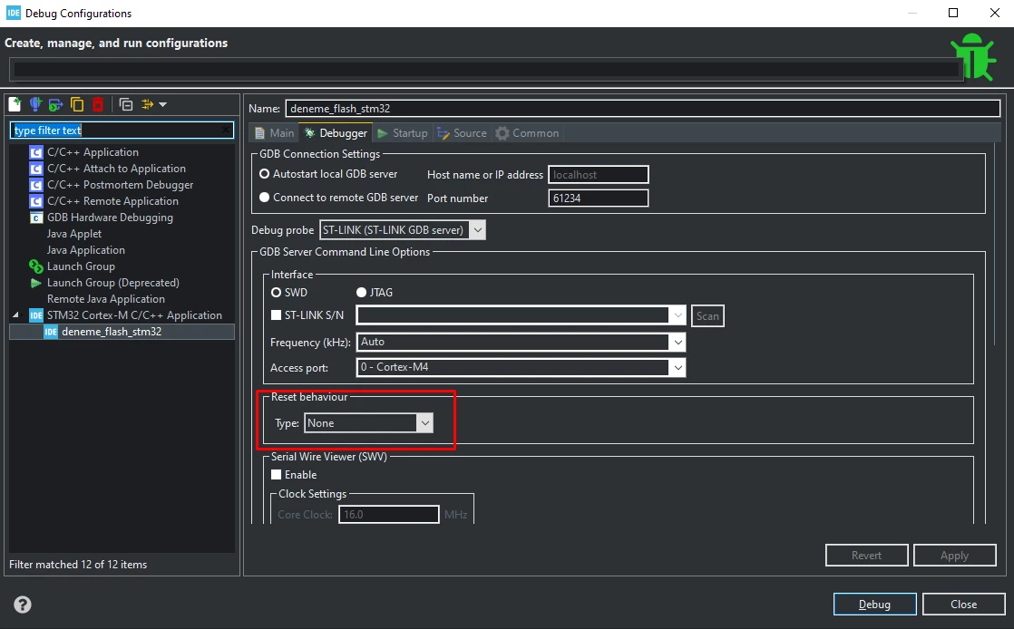

In my case, the WBA became unresponsive.  I could not use the STM32 IDE to program it with anything (was getting the errors you described above).  One forum said you could program with "reset behavior = NONE"... this did not work for me.  One forum said you could use ST-Link and clear the memory... ST-Link could not communicate with the WBA.  Another forum said you could use STM Cube Programmer... STM Cube Programmer could not communicate either.
Here's what I tried and seems to have fixed it.  In my debug configuration, I switched to useing the STLink Open OCD with a known good application.  That appeared to have failed.  When I switched back to STLink GDB Server (which is what I was originally using) and programmed with the known good application, then it worked.
