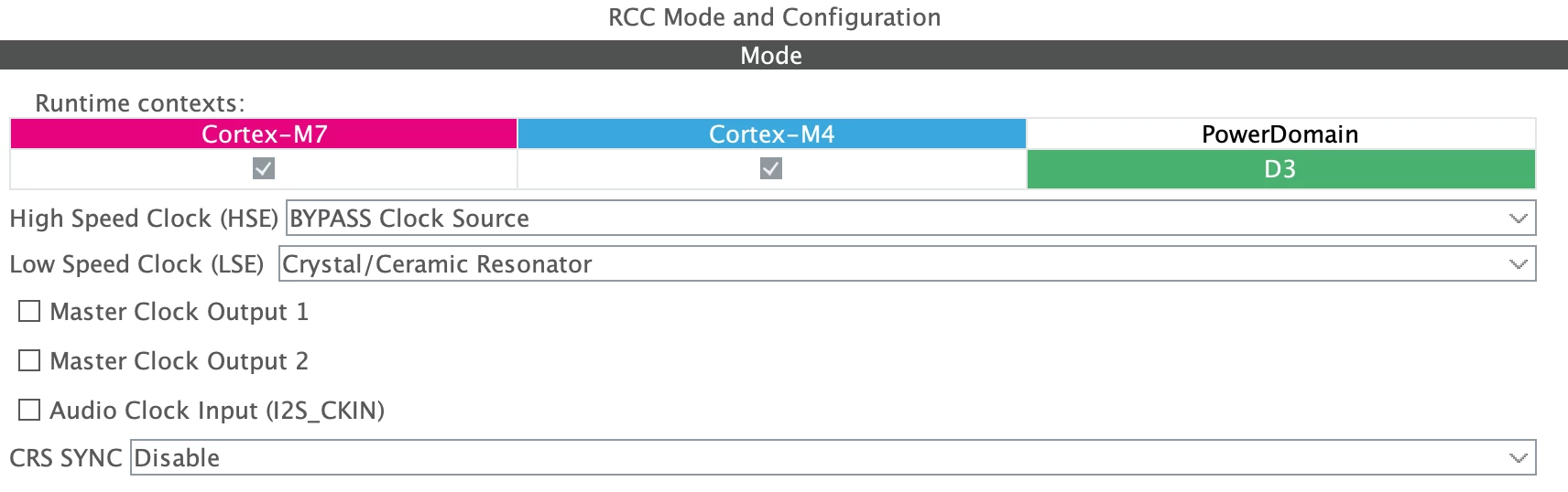

Hi everyone,
I'm working on a project with STM32CubeIDE and an STM32H747 microcontroller. I've configured the clock sources in the .ioc file as follows:
  • High Speed Clock (HSE): BYPASS Clock Source
  • Low Speed Clock (LSE): Crystal/Ceramic Resonator
When I generate the code, the process appears to complete successfully, as I don't receive any error messages. However, when I check the SystemClock_Config function, I don't see the clock configurations that I set. Here is the generated code:

It seems that the settings for HSE and LSE are not included. Can anyone help me understand why this is happening and how I can fix it?

you enabled HSE + LSE - ok.
But what you set/use in clock configuration ? -> This is what is used then in your program. (= generated code).
So show clock tree...   HSI is used - right ?

you are right, I enabled HSE in the clock tree and I noticed the changes in the Code Generator. Thanks, problem solved.
