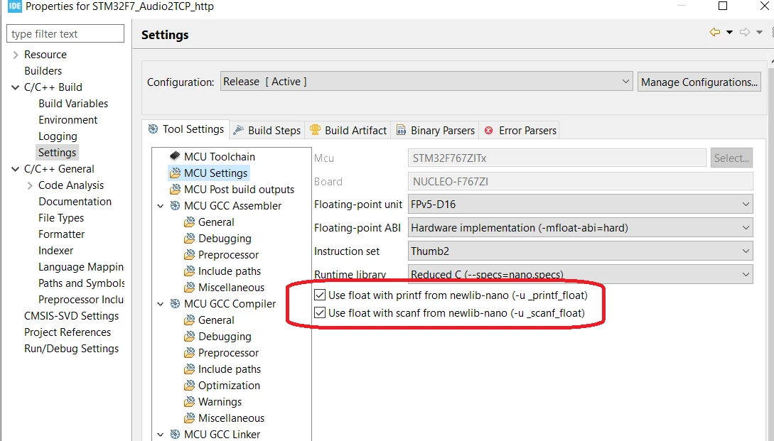

Issue to add sprintf in my code in cube ide
Hai, I am using stm32h743zi nucleo board in that I am send and receiving float via UART using sprintf but facing hard fault error while running , help me to sort ​this issue would be appreciated.
7 replies
LCE
Principal III
November 24, 2021
First of all, normally sprintf is used for writing something into a string.
Second, maybe you need to set these checkboxes in the project settings:
AMuru.1
AMuru.1Author
November 25, 2021
Thanks,I have this done in my code still I am facing the same issue.​
November 24, 2021
Also note that printf/sprintf (and maybe sscanf, not sure) use the heap and a failed allocation can cause a crash.
