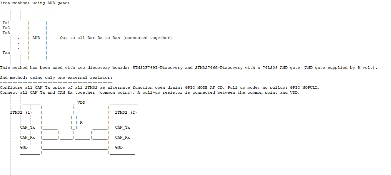

Issue getting two ST micro controllers to communicate with each other using CAN BUS
I currently have two STM32 Micro controllers, One is the NUCLEO-L4A6ZG and the other is the NUCLEO-L4R5ZI-P
I want to communicate between the two using the CAN Transmission but I am confused about a couple errors that I have been hitting, So for reference I've been following this website
Google: Mattewtrendev, Setting Up the CAN Bus on STM32
And I designed my circuit without using a transceiver and instead using resistors and diodes. The tutorial unfortunately doesn't explain how to actually run the programs to see if it's working. I'm kind of a noob when it comes to STM32CUBEIDE programming so I have it right now that both boards are connected to my computer through USBs and in the IDE I have it so each board is two separate projects. IN order to get it running I will run the main form CAN_BUS1 then debug the main from CAN_BUS2 unfortunately when I do this I hit a hard fault and I've been kind of stuck on how to actually run something like this?

mƎALLEm
June 2, 2023
Using CAN in Normal mode without transceivers is not a common HW configuration for CAN bus.
It's used only for quick tests and the distances between nodes SHOULD NOT EXCEED few centimeters.
ST does not support this kind of config.
Meanwhile, (just a courtesy), I remember I did this kind of config years ago with STM32 MCUs and succeeded to establish the communication.
Attached two methods I remember I used for this kind of HW.
