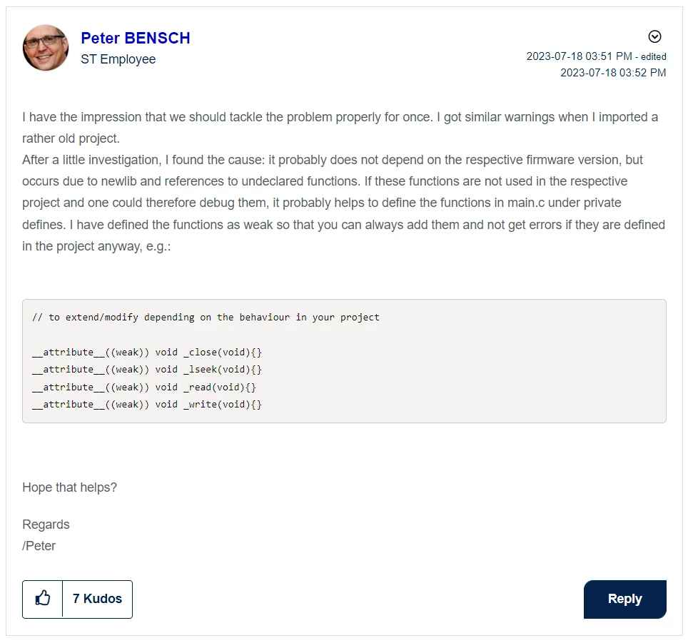

The problem that is causing the failed build was described in CDT (https://github.com/eclipse-cdt/cdt/commit/1b2472faff2028f0323ad5c5eb85565f81b89053).
For more information about these warnings and how fixed them, I advise you to check this post and precisely @Peter BENSCH answer.
