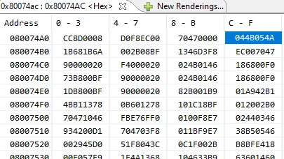

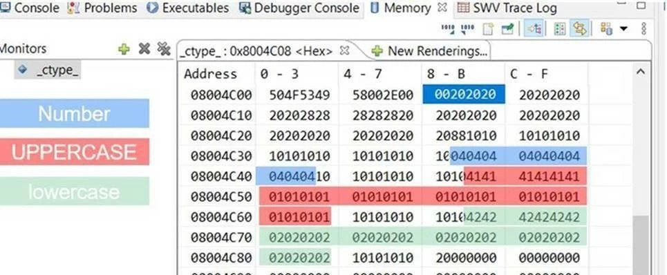

Hello BVauc!
Does this mean that you are currently getting the correct output from isalnum? If so, what did you do? I can’t see anything In the header file that doesn’t match our precompiled versions.
Could you check what pointer __locale_ctype_ptr() returns and then check with the memory view?
It should either return a faulty address or the area where it points is corrupt. That should give an idea of what the problem is.
BVauc.1
BVauc.1Author
January 6, 2021
Hello Markus, thanks for your analyze, you are probably right, the memory contains anything but the patern you show.
