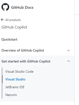

Hi I am also looking for a way to use copilot in STM32CubeIDE. Is there any update on this topic? Its possible to use copilot in visualStudio Code but I am not since I am more familiar with debugging in STM32CubeIDE it would be nice to have also the copilot running there.
