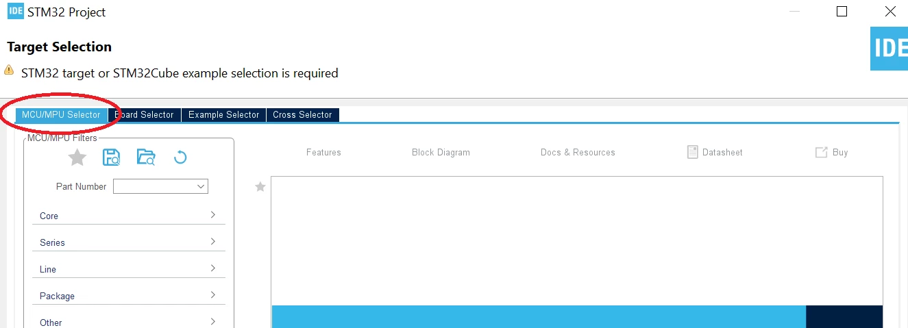

Is there a mechanism for integrating a 3rd party development board with STM32CubeIDE?
We have in production a display product using STM32F496. Currently we offer this with our own software only, but are considering opening up software development to 3rd parties. We would love to be able to integrate this with STM32CubeIDE and TouchGFX in the same way as ST's own discovery and eval boards.
I've found this information on how to develop an expansion package, is there a similar mechanism to integrate a new development board into the environment?

Markus GIRDLAND
Feb 22, 2021 11:52 AM UTC
Hello!
Today there's no possibility to add a board to the integrated MCUFinder inside STM32CubeIDE but you can select the MCU you are developing with (select MCU/MPU Selector instead of Board Selector)0693W000007Z4yDQAS.png
Then you can use whatever custom board you wish and make your application around the MCU accordingly.
If I misinterpret the request then please let me know!

To complete my colleagues view, you anyway have the possibility to describe all the STM32F496 peripherals assignments and configuration of the board you have created using STM32CubeMX or STM32CubeIDE configurator and share the configuration file (ioc) with your customers/partners.
This would help them to carry on the SW configuration on top of a predefined HW configuration.
In ths case, the expansion package you create will be possible to directly use the HW resources reserved on the board.

Thanks for your help. We had already figured we could share the .ioc file I think that gets us 90% of where we wanted to be.
