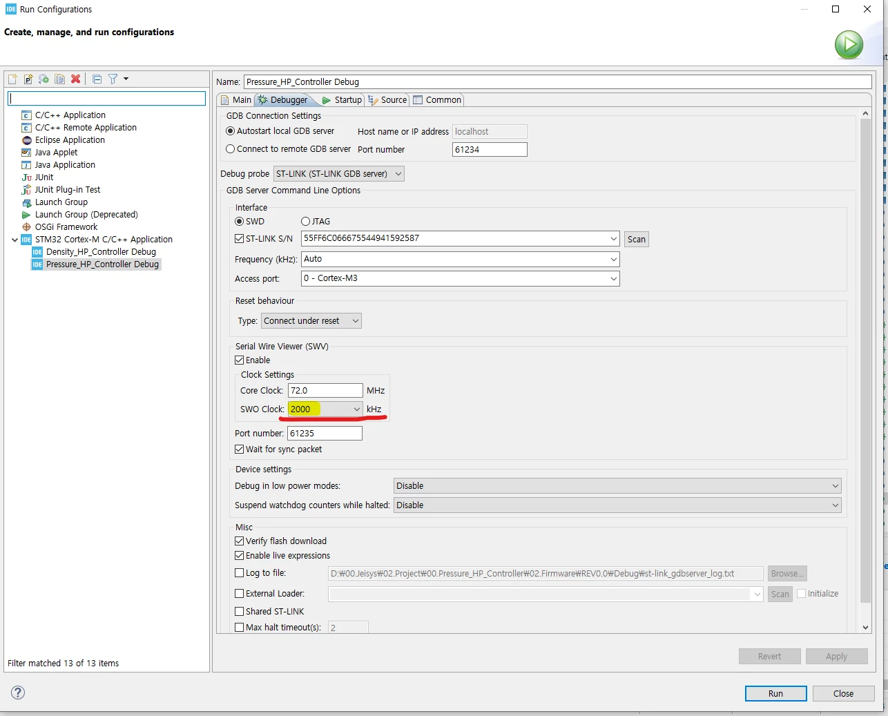

Is the SWO Clock 2000kHz maximum?
Can I set SWO Clock to 2000kHz or higher in Debugger Configurations of STM32CubeIDE?

Not much to work with here.
What STM32? What version of ST-LINK? V2 or V3?
The V3 can get to 24 MHz on H7 parts.

Keil operates at 12Mhz. Is this the difference between the tools?
