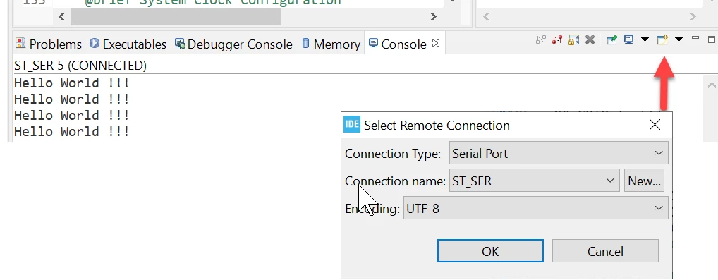

Is it possible to start an STLink serial terminal from within the IDE?
I can manually start Tera Term and connect Serially, but I cannot find how to do this from within the IDE. Is this possible? Maybe a project option that needs enabled?
Using STM32CubeIDE 1.6
Thanks

I just found it. If you click enough buttons (I could not find where the info is in help).
0693W00000AOW22QAH.pngThe info I found online showed the icon for the 'Display Selected Console', so it added a bit of a twist.
Here is how to invoke:
  • Start a Debug session.
  • Click on the Open Console button.
  • Select 'Command Shell Console'.
  • Set Connection Type: 'Serial Port'
    • Click new and give some name, e.g., STLINK_Serial (this name will be available on subsequent access)
    • Set Encoding to UTF-8
  • Click OK to display output
Cheers,
Derek
