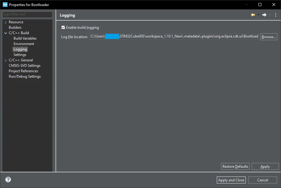

Hello @JSILV.2​
Could you please explain what you mean by CUBE IDE TERMINAL.
From my side I could think of the console.
For the build console you can export it to a log file.
  1. Go to the project properties.
  2. C/C++ Build --> Logging and enable the build logging also the path where to save the log.
But if it is about another console (for serial communication for instance) you could only do a copy/paste to the file you want.
Kind regards,
Semer.
