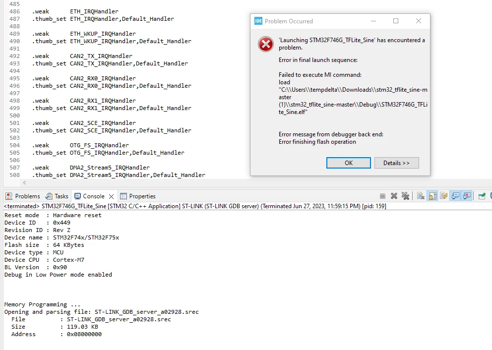

Hi, I do not have enough flash memory on my dev board  (STM32F7508-DK) to launch my program. How can I run it from RAM? Is it possible to toggle CubeIDE for that somewhere?

    This board has 16 MBytes of external QSPI flash and 8 Mbytes of external DRAM.
    Please refer to the board and CubeIDE documentation on using these memories. There are also examples and tutorials.

    @Pavel A. Thank you for your answer. I tried to do that ..
    Here's the documentation which I'm using (Place code in RAM section)
    https://www.st.com/resource/en/user_manual/um2609-stm32cubeide-user-guide-stmicroelectronics.pdf
    Here's my edited files (according to doc)
    flash.ld file
    https://github.com/tempdeltavalue/temp_STM_32_ram/blob/main/STM32F746NGHX_FLASH.ld
    startup file
    https://github.com/tempdeltavalue/temp_STM_32_ram/blob/main/Core/Startup/startup_stm32f746nghx.s
    main file:
    https://github.com/tempdeltavalue/temp_STM_32_ram/blob/main/Core/main.cpp
    but I still see flash memory error...

    Find  a ready file (produced by CubeMX/IDE) named STM32F746NGHX_RAM.ld
    Do not edit anything else yet.
