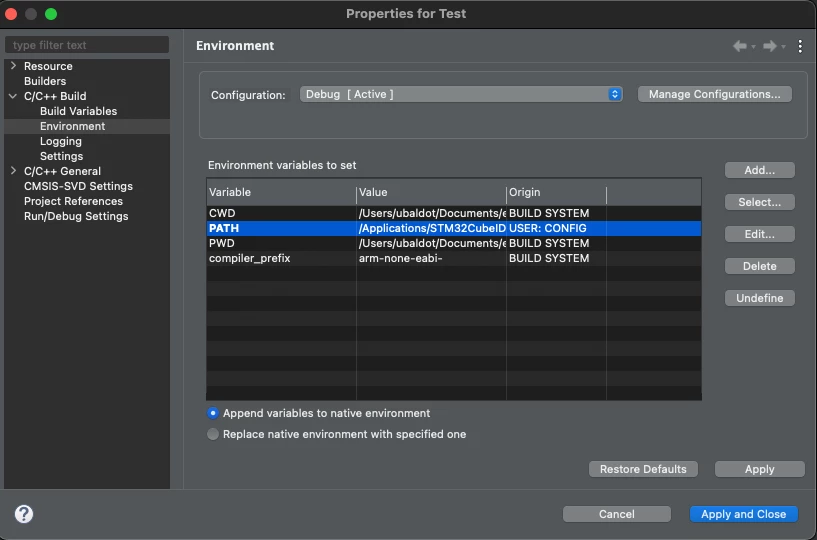

    1) Go on Project->  Properties and change add the folder where compiledb is installed in PATH as shown below.

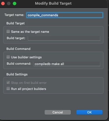

    2) Go to Project -> Build Targets -> Create... Uncheck all the options and add the custom command you need for creating the compile_commands.json file in the Build commands.
    3) Select the newly created target on the left hand side of CubeIDE, right click and select Build Target.

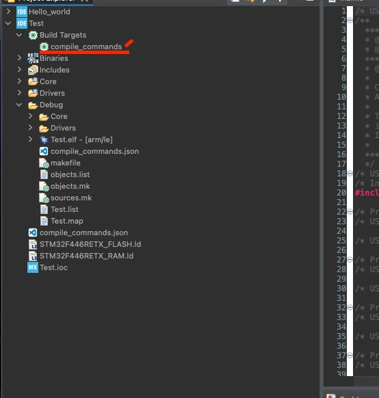

    4) Once your compile_commands.json is created, you have to move it in the upper folder (root of your project).

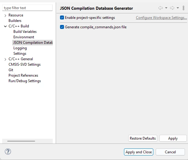

    Aug 18, 2025 07:34 UTC
    I am using STM32CubeIDE version 1.19.0 and I have right clicked my project, gone to properties, C/C++ Build, JSON Compiliation Database Generator. ticked the 2 boxes and away it went.
