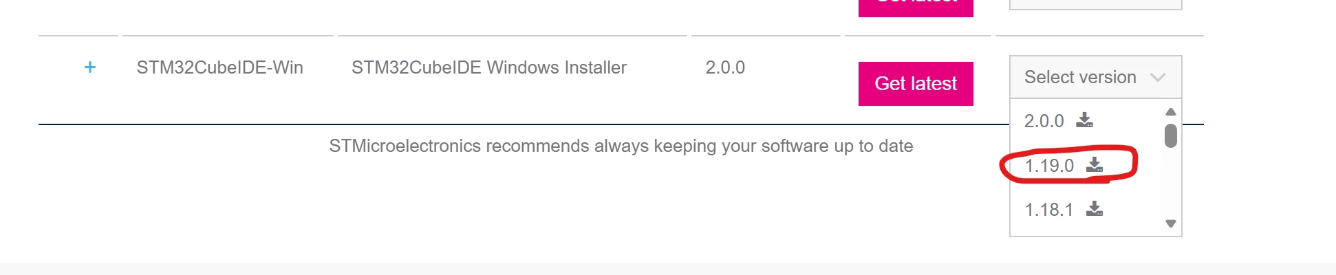

RHJAuthor
Dec 3, 2025 1:28 PM UTC
I'm a little confused about the version number.  The About page says 2.0.0 but the top of the workspace says 1.12.0.
Anyway, I'd prefer to have the config tool incorporated in the IDE.  Can I downgrade to 1.19.0?
TDKBest answer
Dec 3, 2025 2:38 PM UTC
Probably your workspace was created in 1.12.0. It's just a directory name now, not the product version.
Yes you can downgrade if you want.
STM32CubeIDE | Software - STMicroelectronics
