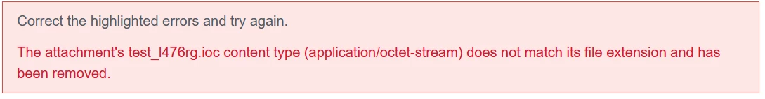

    Hi Peter,
    I am not able to attach the .ioc file (see the attached error message)
    Peter BENSCH
    July 13, 2023
    OK, we need to check again why IOC files are blocked. As an interim measure, could you please try renaming the IOC file to *.IOC.TXT?
