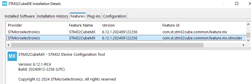

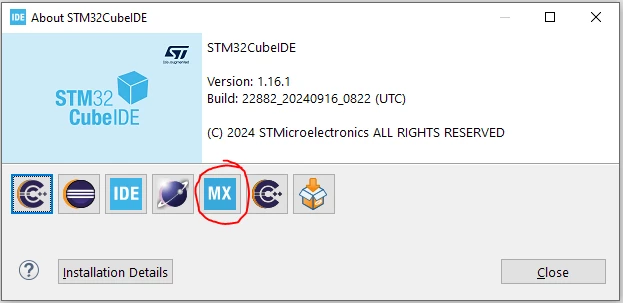

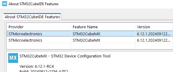

To see MX version:
Help > About STm32CubeIDE > Installation Details >
1. Click the icon
2. Or 'Installation Details'
