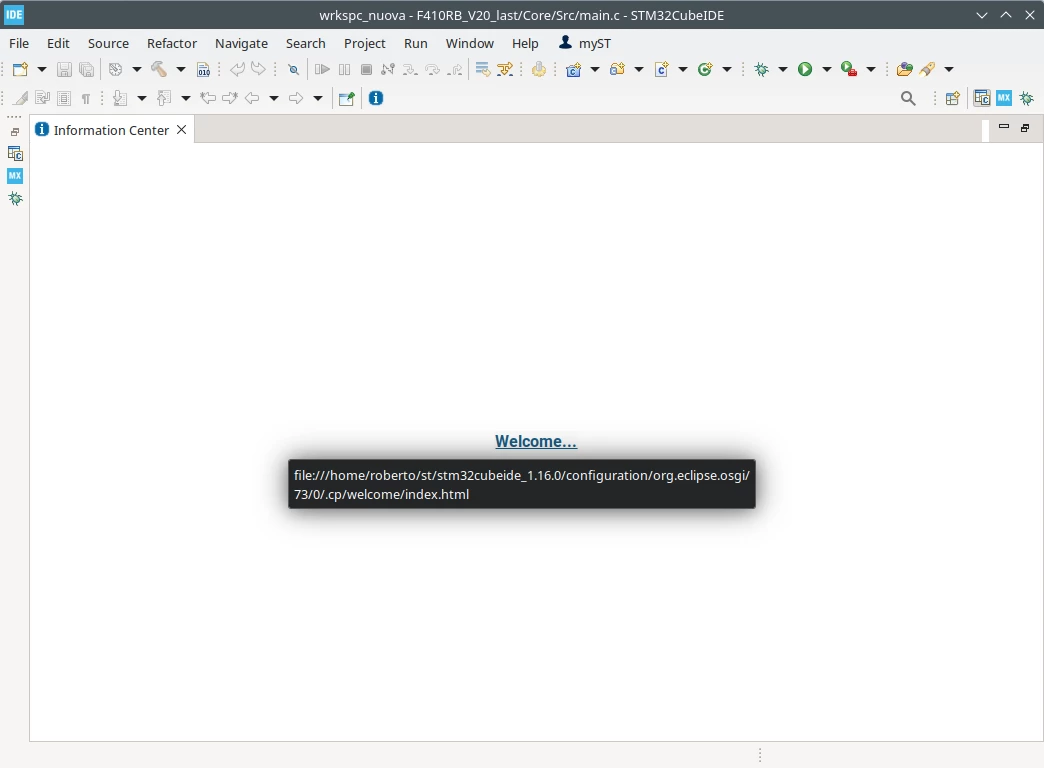

So after installed I opened the program and I found this window instead of the usual
In short the graphical window of the 'Information Center' was not filled with the usual graphical objects, but just a link.
Actually the link works, and if clicked opens Firefox.
So, for every link you will find in CubeIDE it will open Firefox, with a certain delay due to the time required to open it.

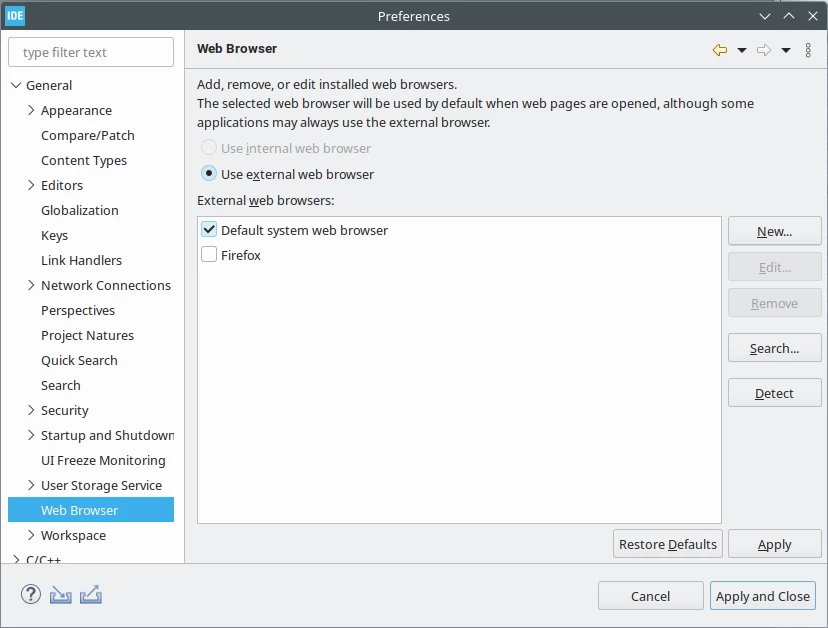

As I said with the CubeIDE 1.13.2, everything was working even the integrated browser (jxbrowser).
I tried to enable the internal browser manually but in the settings the internal browser options is greyed out, so I cannot enable it.
Is anybody out there who can help me in finding out what can I do to enable the internal browser or at least to define which is the problem?

if anyone is interested I found the problem.
Sneeking in the PC, the workspace folder, I found (hidden file) a log that were reporting a missing program, WebKitGTK3 or 4.
Once the missing program was installed everything returned to normality.
