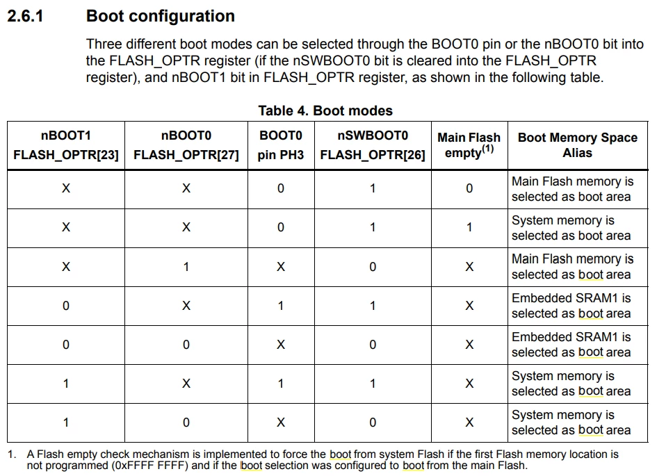

Hi All,
the reason of what you are seeing is due to the PEMPTY flag not being cleared properly by the flash loaders used by STM32CubeIDE/STM32CubeProgrammer, IAR or Keil when downloading the application and starting the debugger.
With the PEMPTY flag set, the STM32 boots from system memory instead of user memory (details at 3.7.5 in the RM0394 Rev 4)

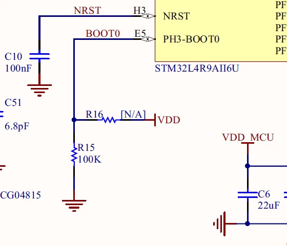

> PH3-BOOT0 pin pulled to ground with 10k Ohm resistor
That means, you're already suspecting this is bootloader entry, and so do I.
Check for bad solder joints and shorts. Decrease the value of that resistor.

Hey JW,
Thanks for your reply! PH3-BOOT0 was my first suspicion but this project was originally created and running in Keil uVision IDE before being ported to CubeIDE a year ago. I don't recall seeing this issue in Keil before, but it may have just gone unnoticed or maybe Keil handled it differently.
Based on your response, are you stating that PH3-BOOT0 is still read to determine the application start address even when using the debugger in CubeIDE?
Edit:
Looking at the STM32L4R9I-DISCO devkit from which this project was based on, it appears PH3-BOOT0 is pulled to ground with a 100K ohm resistor.

I did read in the MCU datasheet that if the application flash bank is erased that it will default to the system memory (bootloader) space. Since I am not changing the option bytes, and based on the responses so far, it could be one of the following:
1. PH3-B00T0 has a bad connection to ground.
2​. STM32CubeIDE or ST-Link is not properly programming the flash or is erasing the first page/sector after programming and verification completes.
"Verify" is enabled but I wonder if it's booting the application even if verification fails.​ Maybe I can find those details in the logs.

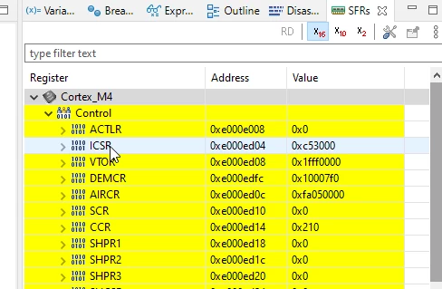

I have a similar problem. I found out, that the debugger obviously does not set the Vector Table correctly
I case of a non running debug session, I can halt the CPU and look at CPU register "VTOR", which stores the Vector table address.
0693W00000Bb1DsQAJ.pngHere: VTOR points to 0x1FFF0000
Now we need to know, how to encourage the debugger to set VTOR correctly every time. ...

waclawek.jan
Jun 15, 2021 12:30 PM UTC
That's the consequence of starting into bootloader - it's the bootloader, not the debuigger, which sets VTOR to the bootloader area.

In my design, I have a problem, that the debugger correctly stops at "void main()" and then gets lost when initializing "HAL_Init()". I use Timer 7 for system-TIC. I observe that the software gets lost as soon as the HAL initializes Timer 7 interrupt and then jumps into the bootloader
To clarify
I can see, that my program stops correctly at void main(), but VTOR points to 0x1FFF0000. Why is that? who sets VTOR at debug start? I assume, that the SWD / JTAG debugger will set some processor registers upon debug start. How would my software get to "void main()" but VTOR still pointing to bootloader?
I think, there is something wrong during debugger start. Maybe the debugger has modified the Programm counter correctly to reset vector (my program) but setting VTOR to zero failed somehow.
I never dealt with debug start. Is there some script running during debug start? Does anyone know where to look?

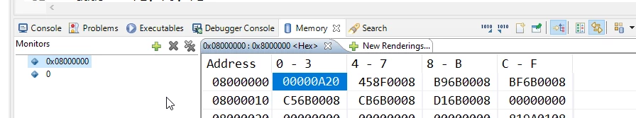

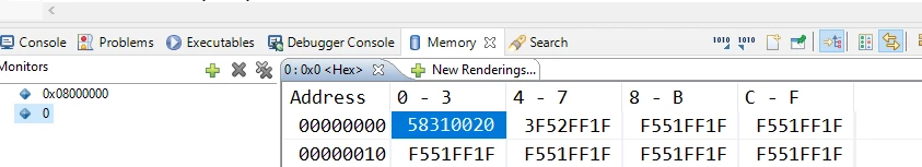

Another strange observation:
When the debugger starts correctly, the flash-memory is mapped to 0x00000 (correctly)
If the debugger is not about to start correctly, the flash memory is NOT visible at 0x00000. But the register "SYSCFG / MEMRMP" (memory-remap) is zero, which means, that the flash should be visible at 0x000000
This is flash content. This is the vector table. First Stack-Pointer, Second: Reset-Vector
This is the memory content at 0, should have been exactly the same as 0x08000000. but it isn't. Reset Vector points to 0x1FFF51F5 (obviously bootloader code)
But Memory-Remap-Register shows zero. Flash should be remapped to zero.

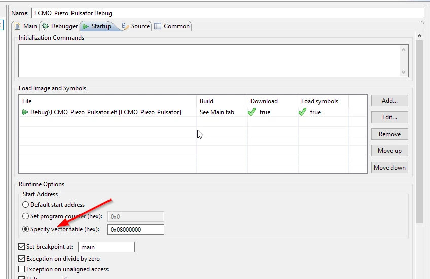

Johannes
Senior
Jun 15, 2021 2:48 PM UTC
0693W00000Bb3H3QAJ.pngBy the way: Playing with this setting does not do anything.
