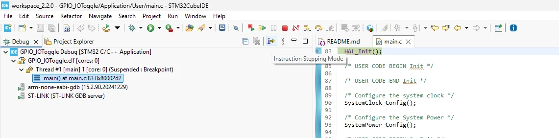

After updating (and later performing a full uninstall/reinstall) to STM32CubeIDE 2.2.0, the "Instruction Stepping Mode" toggle command has completely disappeared, and it appears the underlying command is no longer registered at all — not just hidden from the toolbar.
Version:
STM32CubeIDE Version: 2.2.0
Build: 29186_20260626_0934 (UTC)
OS: Windows
Steps to reproduce:
  1. Start a debug session on an STM32H7 target
  2. Open the Disassembly view
  3. Try to enable "Instruction Stepping Mode" to step at the assembly instruction level
Observed behavior:
  • The icon is no longer present in the Debug toolbar
  • Giving focus to the Disassembly view does not automatically enable instruction-level stepping (F5/F6 still step at C source line level only)
  • Going to Window > Perspective > Customize Perspective > Toolbar Visibility, the command "Instruction Stepping Mode" is listed in the Debug toolbar structure, but checking its checkbox and clicking "Make Item Visible" throws the error: "'Instruction Stepping Mode' command cannot be made visible in this dialog."
  • Checking Window > Preferences > General > Keys to manually assign a keyboard shortcut: the command does not appear in the list at all, suggesting the command contribution itself is not being registered by the plugin in this build.

Hello ​@DADD
The "Instruction Stepping Mode" is present just below the Debug toolbar as shown in the screenshot below:
Could you recheck please?
Thank you,
BR, Souhaib

Souhaib,
Thank you very much for taking the time to show me where the icon is located.
That said, I must admit that this location is far from intuitive – or at least, I don't quite understand the logic behind it. I believe it used to be in the toolbar in previous versions.
