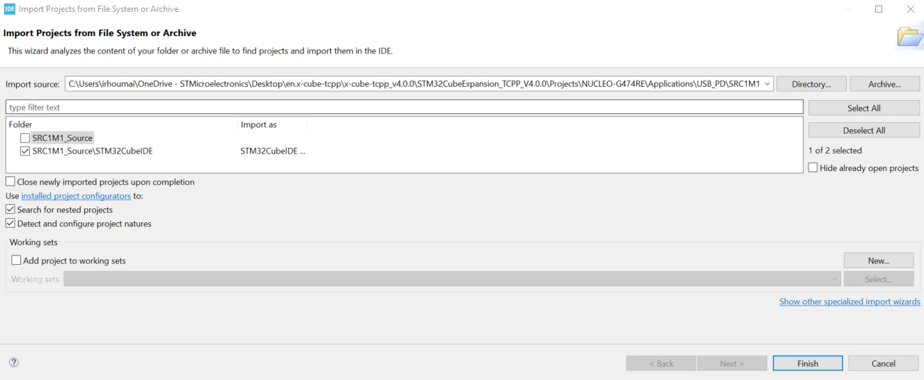

    • Select File-> Open Projects From File System...
    • On the import Source: select the Source of your project  (for example : "Desktop\en.x-cube-tcpp\x-cube-tcpp_v4.0.0\STM32CubeExpansion_TCPP_V4.0.0\Projects\NUCLEO-G474RE\Applications\USB_PD\SRC1M1_Source").
    • Select Just the STM32CubeIDE project as shown here:
    • Click on Finish.
    • The Project is generated, you can Now compile it.
    • Click on Finish.
