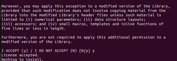

I am trying to install CUBE ide in ubuntu OS,  stmCubeIDE.sh script was successfully ran and i accepted all licence,But at last it says "Licence accepted Nohing to install" How resolve this issue?

    Hello @Yuktheshwar Bhat
    Have you tried the same method as in the UM2563.
    Best regards.
    II
    AScha.3
    September 29, 2023
    do:
    sudo sh ./st-stm32cubeide.sh
