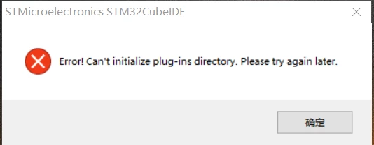

Installation prompt failed to initialize plug-in directory
0693W000006HOm7QAG.png[,],\stm32cubeide\d\c\c\用户\c

Excuse me, the installation of stm32cubeide prompts how to solve this problem. The installation file is stored in the root directory of the d disk. The administrator folder in the user directory of my c disk is in Chinese. Does this have an impact?
Possible answer:
It looks like you are installing in a customized folder: \stm32cubeide\d\c\c\用户\c
Please try to install STM32CubeIDE into a folder with minimum number of ANSI characters, e.g. C:\ST. The reason for this is the very long path length that the Eclipse and GNU GCC tools already contain.

好的,�?�常感谢。我使用�??称 st 在�?盘 d 上定义了文件夹,然�?�将安装包放入该文件夹,然�?��?�击它。但我还是�??出了这个问题。这与�?盘 C 的用户的中文管�?�员目录有关�?�?
