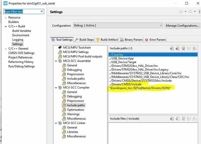

Hello, I recently had a compilation error with STM32CubeIDE 1.14.0. A json.h file is not found by the compiler, yet I have included the path in the project properties, as shown in the photo.
The file is present in the project/drivers/JSON directory. If I move the file to project/core/inc, the compilation works.
Another oddity, I can't find where the paths to project/drivers/NTC and project/drivers/OLED are registered? Yet the compilation works (without json.h).
Thank you.

    Hello @guillaumefaye,
    In the section Properties > C/C++ Build > Settings > Tool Settings > MCU GCC Compiler > Include paths, you should include the path ../Drivers/JSON . For your second question, It's not necessary to add the paths ../Drivers/NTC  and ../Drivers/OLED to the include paths unless they contain header files that your project requires.
    Thanks but it is already included in the properties, see the photo.

    @guillaumefaye
    Certainly! I mean you need to delete the entry "${workspace_Ioc:/${ProjName}/Drivers/JSON}" and manually add  ../Drivers/JSON .

    Try <json.h> instead of "json.h".
    Also note that relative paths like ../Core or ../Drivers can cause errors. Prefer absolute paths, such as the last include dir in your first post. Use the eclipse macros ${ProjectDir},  ${workspace_loc} and so on, or custom build variables .

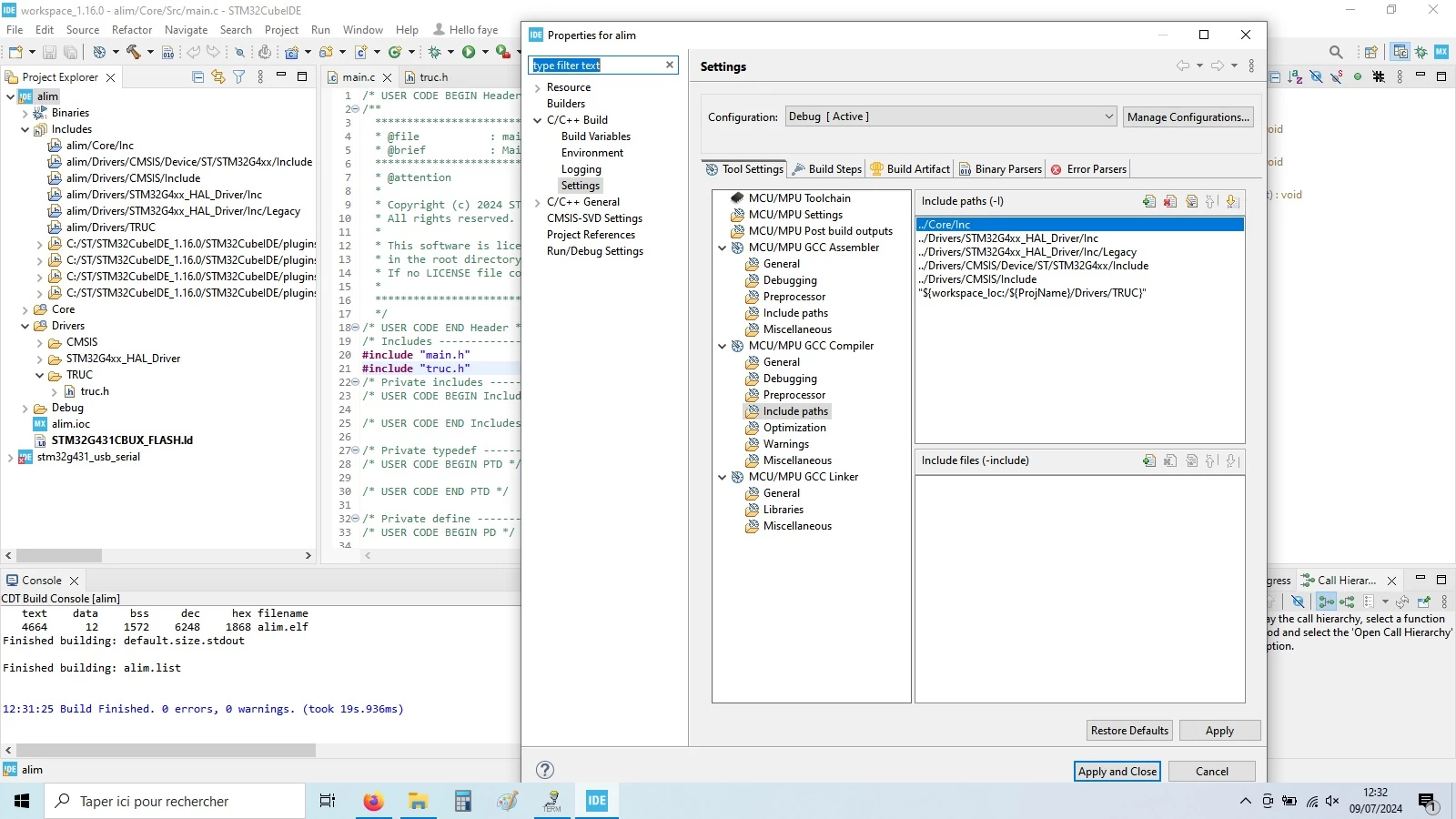

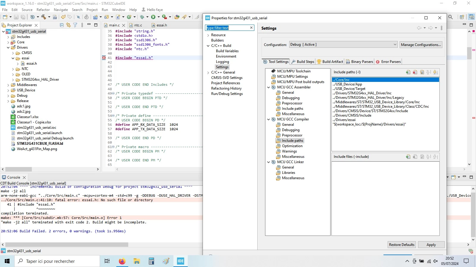

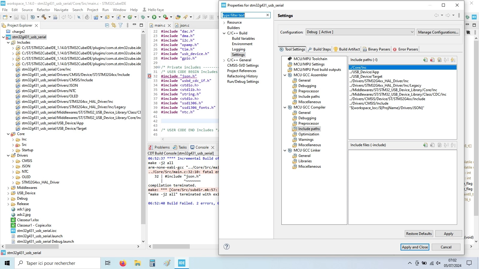

    there is another strangeness, i remove all files folder and ref to json. It's compil but i can't see where is the path to ntc.h or oled.h , i had manualy add this, but I don't remember how.
    In picture, we can see the project tree, compilation result , properties tree.

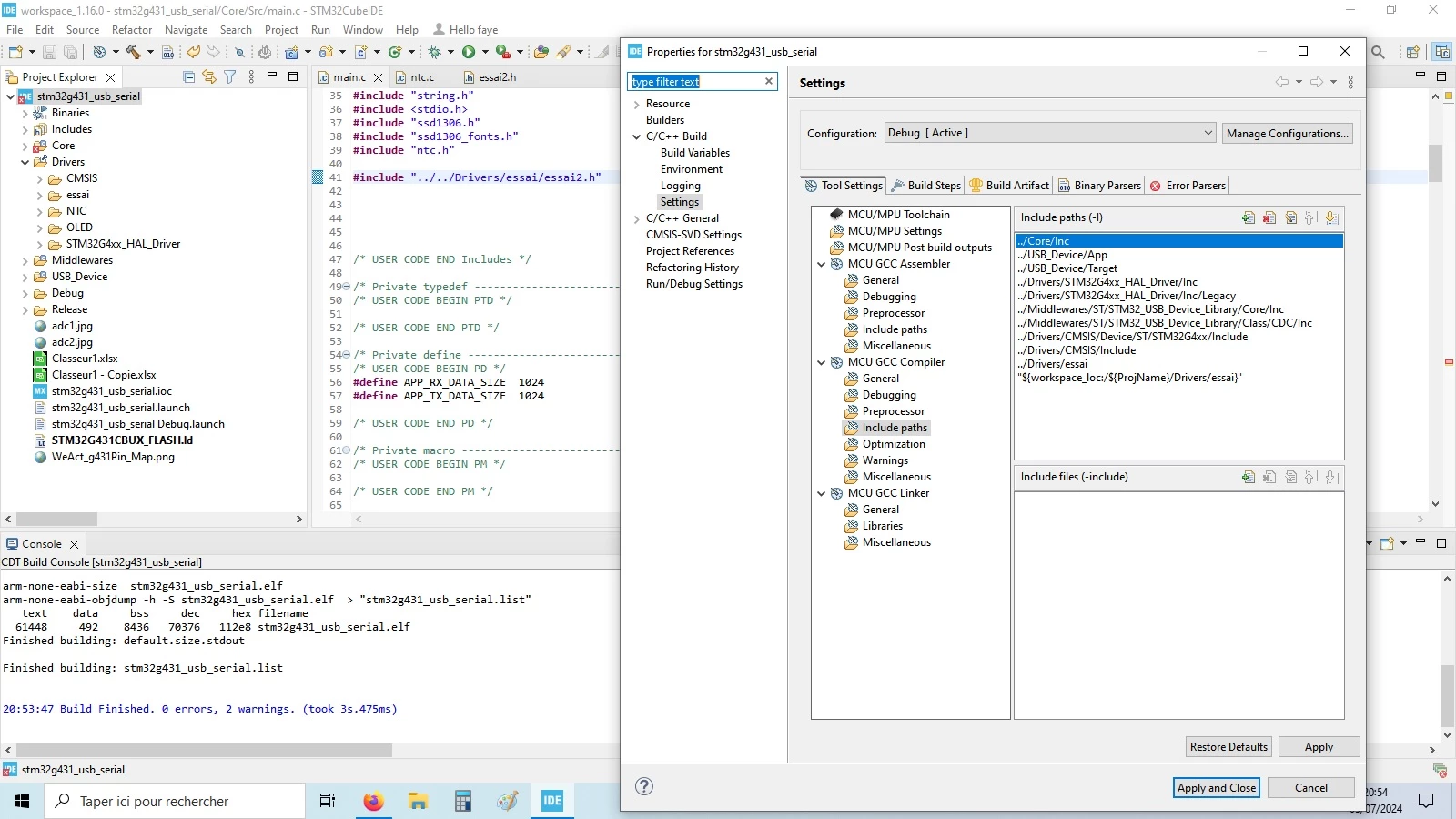

    with the full link in the name, it compiles........without path link.

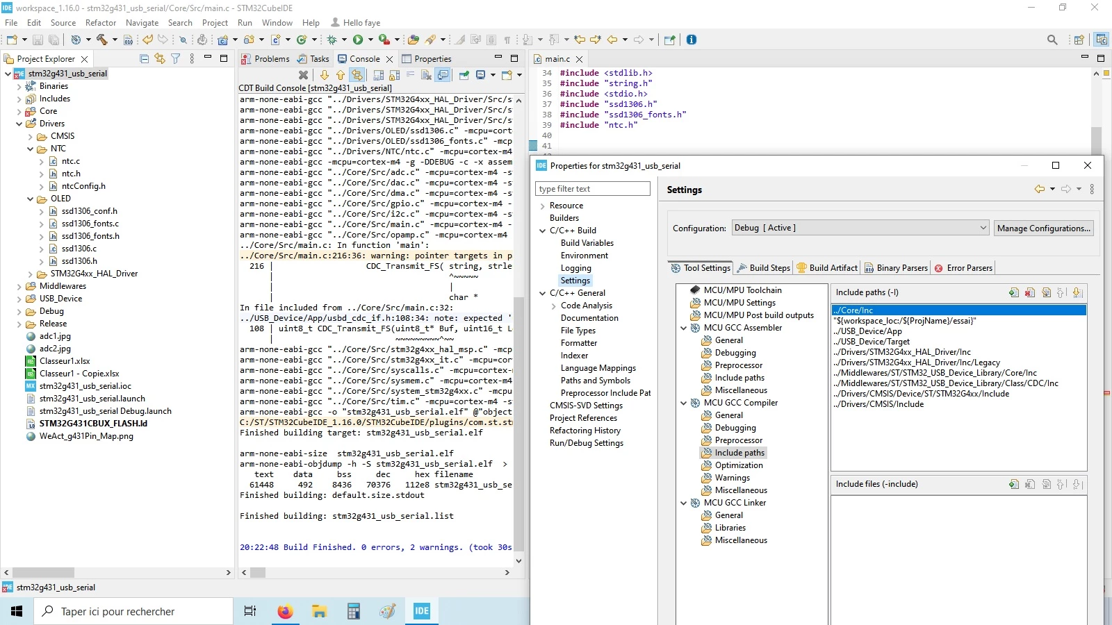

    strangely with a new project, the inclusion of a new.h file works well with the configuration screen.
    It must be an option in the properties, but I don't know how to modify that......do you have an idea?

    I think it just tells that there is some kind of retrictions in the files or subfolders. (like some file is exluded from the build , or like in this case some folder is not included in the source folder list).
    https://mcuoneclipse.com/2012/07/30/icon-and-label-decorators-in-eclipse/
    I believe drivers/NTC and /drivers/OLED folders,however, are included to the sourcle folder list since these folders work.

    guillaumefaye
    July 10, 2024
    i can reset the key icone on my folder "driver" but always not build.
    it seems that the path is not taken into account.
