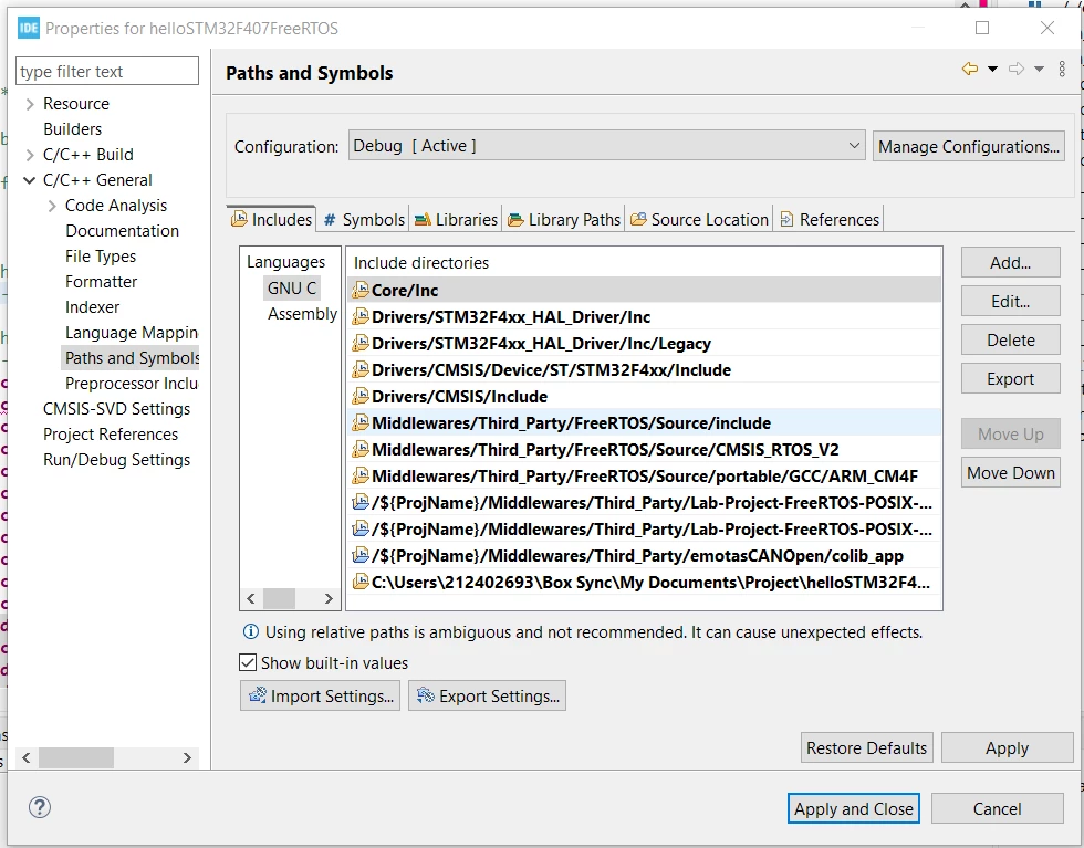

Include not works in STM32CubeIDE
STM32CubeIDE Version: 1.14.0 Build: 19471_20231121_1200 (UTC) OS: Windows 10, v.10.0, x86_64 / win32 Java vendor: Eclipse Adoptium Java runtime version: 17.0.8.1+1 Java version: 17.0.8.1
include setup
and the exported xml content
<option IS_BUILTIN_EMPTY="false" IS_VALUE_EMPTY="false" id="com.st.stm32cube.ide.mcu.gnu.managedbuild.tool.c.compiler.option.includepaths.256299597" name="Include paths (-I)" superClass="com.st.stm32cube.ide.mcu.gnu.managedbuild.tool.c.compiler.option.includepaths" useByScannerDiscovery="false" valueType="includePath">
<listOptionValue builtIn="false" value="../Core/Inc"/>
<listOptionValue builtIn="false" value="../Drivers/STM32F4xx_HAL_Driver/Inc"/>
<listOptionValue builtIn="false" value="../Drivers/STM32F4xx_HAL_Driver/Inc/Legacy"/>
<listOptionValue builtIn="false" value="../Drivers/CMSIS/Device/ST/STM32F4xx/Include"/>
<listOptionValue builtIn="false" value="../Drivers/CMSIS/Include"/>
<listOptionValue builtIn="false" value="../Middlewares/Third_Party/FreeRTOS/Source/include"/>
<listOptionValue builtIn="false" value="../Middlewares/Third_Party/FreeRTOS/Source/CMSIS_RTOS_V2"/>
<listOptionValue builtIn="false" value="../Middlewares/Third_Party/FreeRTOS/Source/portable/GCC/ARM_CM4F"/>
<listOptionValue builtIn="false" value="&quot;${workspace_loc:/${ProjName}/Middlewares/Third_Party/Lab-Project-FreeRTOS-POSIX-master/FreeRTOS-Plus-POSIX/include}&quot;"/>
<listOptionValue builtIn="false" value="&quot;${workspace_loc:/${ProjName}/Middlewares/Third_Party/Lab-Project-FreeRTOS-POSIX-master/include}&quot;"/>
<listOptionValue builtIn="false" value="&quot;${workspace_loc:/${ProjName}/Middlewares/Third_Party/emotasCANOpen/colib_app}&quot;"/>
<listOptionValue builtIn="false" value="&quot;C:\Users\212402693\Box Sync\My Documents\Project\helloSTM32F407FreeRTOS\Middlewares\Third_Party\emotasCANOpen\colib_app&quot;"/>
</option>
the problem is when compile I always get can't find head file errors and the real compile commond -I never setup as above. the real compile command below,

    I solved the problem in case your need,
    the folder can set inlucde path differrent with the project, you can see in below xml. the project include works fine after I set midware folder inlcudes right.
    <folderInfo id="com.st.stm32cube.ide.mcu.gnu.managedbuild.config.exe.debug.168395613." name="/" resourcePath="">

    Pavel A.
    March 21, 2024
    Please note that some of include items on your screenshot have the small yellow bang icon - this means that the path has NOT been found. And the notice below the frame, about relative paths. Please fix the include paths so that they can be resolved (and the yellow thingies go away).
    sayhi2008Author
    March 21, 2024
    thanks for this advice. but you can see in the compile command that all these yellow bang icon includes don't have problem, as I marked black below. so I don't think that's the problem.
    arm-none-eabi-gcc "../Middlewares/Third_Party/emotasCANOpen/colib_sl/src/co_event.c" -mcpu=cortex-m4 -std=gnu11 -g3 -DDEBUG -DUSE_HAL_DRIVER -DSTM32F407xx -c -I../Core/Inc -I../Drivers/STM32F4xx_HAL_Driver/Inc -I../Drivers/STM32F4xx_HAL_Driver/Inc/Legacy -I../Drivers/CMSIS/Device/ST/STM32F4xx/Include -I../Drivers/CMSIS/Include -I../Middlewares/Third_Party/FreeRTOS/Source/include -I../Middlewares/Third_Party/FreeRTOS/Source/CMSIS_RTOS_V2 -I../Middlewares/Third_Party/FreeRTOS/Source/portable/GCC/ARM_CM4F -I"C:/Users/212402693/Box Sync/My Documents/Project/helloSTM32F407FreeRTOS/Middlewares/Third_Party/Lab-Project-FreeRTOS-POSIX-master/FreeRTOS-Plus-POSIX/include" -I"C:/Users/212402693/Box Sync/My Documents/Project/helloSTM32F407FreeRTOS/Middlewares/Third_Party/Lab-Project-FreeRTOS-POSIX-master/FreeRTOS-Plus-POSIX/include/portable/st/stm32l475_discovery" -I"C:/Users/212402693/Box Sync/My Documents/Project/helloSTM32F407FreeRTOS/Middlewares/Third_Party/Lab-Project-FreeRTOS-POSIX-master/FreeRTOS-Plus-POSIX/include/portable" -I"C:/Users/212402693/Box Sync/My Documents/Project/helloSTM32F407FreeRTOS/Middlewares/Third_Party/Lab-Project-FreeRTOS-POSIX-master/include/FreeRTOS_POSIX/sys" -I"C:/Users/212402693/Box Sync/My Documents/Project/helloSTM32F407FreeRTOS/Middlewares/Third_Party/Lab-Project-FreeRTOS-POSIX-master/include" -O0 -ffunction-sections -fdata-sections -Wall -fstack-usage -fcyclomatic-complexity -MMD -MP -MF"Middlewares/Third_Party/emotasCANOpen/colib_sl/src/co_event.d" -MT"Middlewares/Third_Party/emotasCANOpen/colib_sl/src/co_event.o" --specs=nano.specs -mfpu=fpv4-sp-d16 -mfloat-abi=hard -mthumb -o "Middlewares/Third_Party/emotasCANOpen/colib_sl/src/co_event.o"
    sayhi2008AuthorBest answer
    March 25, 2024
