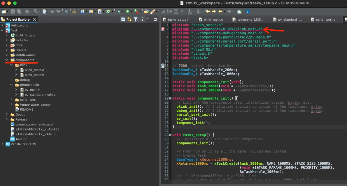

I have a source folder named components where each subfolder has a .c and a .h file, see screenshot below.
I am trying to include these files, but they cannot be found. So far, I know that I should add the relative path and so I did. (I also tried to replace the ../ with the ./ in the #include).
How to solve?

    Solution:
    Project -> Properties -> C/C++ Build -> Settings -> MCU GCC Compiler -> Include paths and I added ../components
    At this point, I can include the headers inside the components folder with e.g.
    #include "blink/blink_main.h"

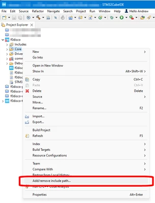

    Note that you can also specify a folder as an Include Path by right-clicking in the Project Explorer:
    https://community.st.com/t5/stm32cubeide-mcus/cmsis-dsp-and-stm32cubeide/m-p/630989/highlight/true#M23664
