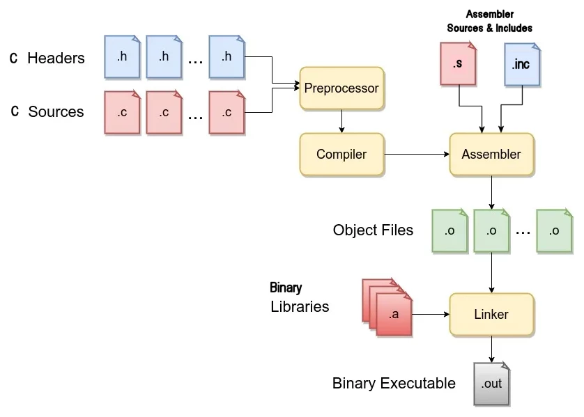

On the distinction between source and binary:
Traditionally, "Library" was used to mean a pre-built binary library.
Nowadays, people also commonly speak of source-code libraries.
https://www.stackzero.net/compilation-process-in-c/

Andrew Neil
March 4, 2024
A header file is not a library - it just defines the interface to the library.
So, in addition to that header, you will also need the library code itself - either as a pre-built binary, or as source code.
  • You use Project->Properties->MCU GCC linker->libraries to specify a pre-built binary library - see the links posted by @STTwo-32
  • If it's a source code library, you add all the source to your project, so  that it gets built as part of your project.
