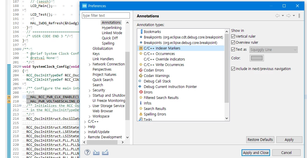

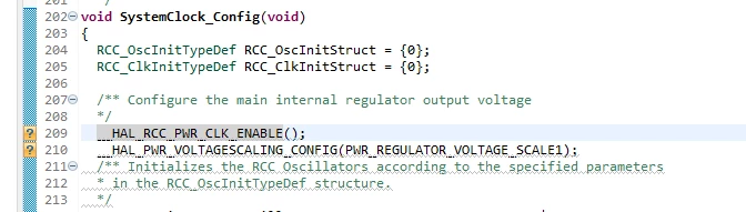

0693W00000Dpl9OQAR.pngThere are ? mark on source file.

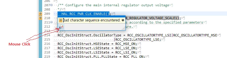

and when mouse placed there, they say "bad character sequence encounter : \" .
How can i clear ? mark and error message?

Both statements are macros that are likely to cause this problem.
Please check whether you can access their definitions, e.g. with F3. The macros should be located in stm32f4xx_hal_rcc.h or stm32f4xx_hal_pwr_ex.h.

'?' are cleared by changing following option.
preference >> general >> editors >> text editors >> Annotations
Vertical Ruler ---> unchecked
Overview Ruler ---> unchecked.

Interesting because it's just the text editor whose options you changed there.
With which annotation type did you switch that: Bookmark, Breakpoints, ... Warnings?

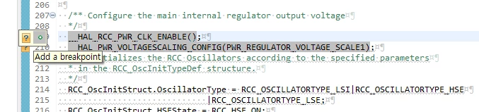

When I press F2 key , a message window appears with a ICON;
If click the icon, the Annotation window is displayed.
I have lifted the check points mentioned yesterday there.
I don't understand what you meant by Breakpoint and Bookmark you mentioned. However, as shown in the attached picture, the message 'Add a breakpoint' was displayed.
Please refer to the 3 picture below.

I meant exactly this menu Annotations, to which you indicated the path. It is also reachable from the Eclipse main screen by
Window > Preferences > General > Editors > Text Editors > Annotations
However, you forgot to mention the Annotation Type, where you changed some settings, which can also be seen on your screenshot: C/C++ Index Markers.
Anyway, this setting was most likely not the cause of the question marks, but rather the lack of or incomplete indexing.
