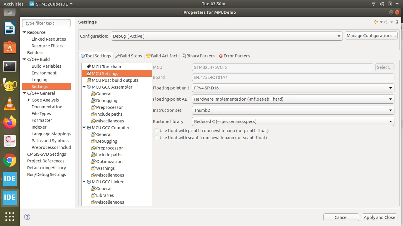

In STM32Cube IDE, I could not select the MCU in Project->Properties-> MCU settings.
  • September 19, 2022
  • 3 replies
  • 4056 views
0693W00000SvjWXQAZ.pngHi,
I am trying to convert an existing STM32L4 project to STM32F4 project. But when tried to change the settings I could not edit the MCU and Board details in STM32Cube IDE.
Please look that snapshot as attached. I want to change MCU to STM43F407VGTx.
Please reply.

Hi @AMuth.3​,
Currently STM32CubeIDE doesn't support the feature to import an existing project from one MCU to another.
The workaround is to generate project with STM32CubeMX as a stand alone tool and select STM32CubeIDE as target IDE. and when migrating with the STM32CubeMX project, from MCU1 to MCU2, a new IDE project will be generated.
I advise you checking the "MCU1 to MCU2 migration option within STM32CubeIDE" FAQ.

Hi @ChahinezC​ ,
Thanks for your reply. But STM32CubeMX is asking the .ioc file to open the existing project.
I could not find that file in my existing project. I am using demo project of STM32L4.. sourced from a FreeRTOS release.
Is there any other way still to use STM32CubeMX as my solution or do any other tools are available to my need?
