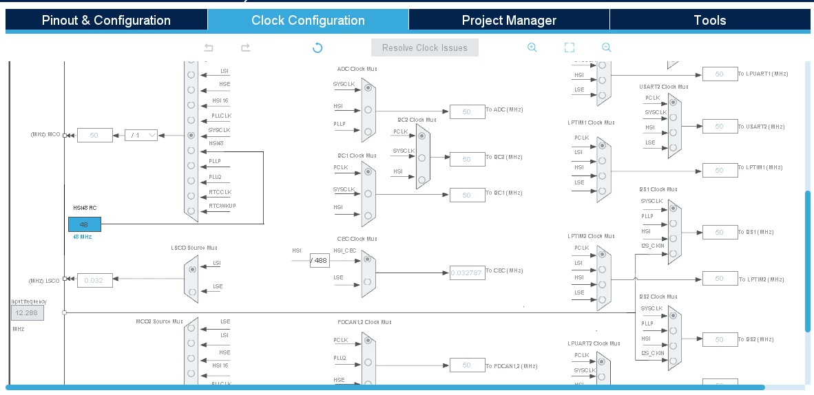

In STM32-G0B1RE, I have an issue of SPI peripheral clock configuration and clock initialization.
I'm trying to communicate with external device using SPI, but I'm not getting any SPI peripheral clock at configuration level and there is no clock initialization details in SPI Init();
1 reply
July 23, 2024
I'm not sure what you're showing us here, perhaps a misunderstanding?
HAL_SPI_MspInit initializes the pins, that's it. The peripheral initialization will be in MX_SPI1_Init which calls HAL_SPI_Init. The function MX_SPI1_Init should be in main.c.
